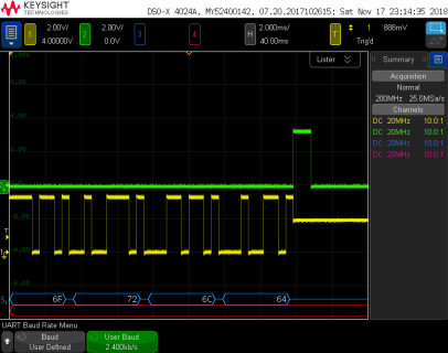

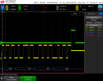

Why go to all this trouble to craft your own ISR when the supplied code provides Serial1.flush() and Serial1.end() ?
My guess is you're going to answer that you may believe the supplied Serial1 code isn't good enough for your project's tight timing requirements? If that's really your motivation, I'd like to ask whether you've actually tested it?
I ran a quick test just now, with this very simple program.
  pinMode(4, OUTPUT);
  Serial1.begin(2400, SERIAL_8N2);
  Serial1.print("Hello World");
  Serial1.flush();
  Serial1.end();
  digitalWriteFast(4, HIGH);
  delay(1);
  digitalWriteFast(4, LOW);
  delay(100);
I connected two 10K resistors to the TX1 signal (digital pin 1), so when the TX1 transmitter shuts off the signal will "float" to a distinct voltage that isn't logic low or logic high. This code also creates a pulse after Serial1.end() finishes, so we can see how quickly your PWM measuring code might be able to run. Here's how the waveforms look my oscilloscope.
As another quick test, I changed SERIAL_8N2 to SERIAL_8N1, so it only transmits 1 stop bit. Here's the result.
It's pretty clear to see the speed of turning off the serial port and running other code is so much faster than 1 stop bit time, at least at this fairly slow baud rate. So much trouble to mess with custom interrupts hardly seems worthwhile.
Then again, if your answer is you simply love playing with interrupts and hardware registers, of course keep going. But if you just want to get your project working, maybe try using the existing Serial1 functions. They work very well.
