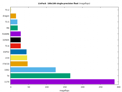

    Double and single precision floating point looks good.
    Linpack 100x100 mflops
                   double    float
        T4@600mhz   71.4     166.3   gcc -O3
        M7@600mhz   66.97    125.5   ARM CC -O3
      T3.6@256mhz    2.85     41.1   Fastest
      T3.6@180mhz    2.13     28.4   Faster
      T3.2@120mhz    0.65      1.0   Faster  no FPU
      adaM4F@120mhz  1.4      20.1   SAMD51
      STM32L4@80mhz  0.88     15.4   dragonfly -O2
      STM32F405@168  1.8      28.3   -O2 adafruit

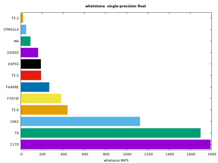

    whetstone   (MIPS)
                       float  double
        T4@600mhz     1694.9  1351.4
        M7@600mhz      939.7   543.6   NXP 1062 SDK
        M7@600mhz     1123.6   510.2   NXP 1052 mbed
      T3.6@180mhz      438.6    34.6
      T3.5@120mhz      189.4    16.2
      T3.2@120mhz       20.9    13.0
      adaM4F@120mhz     90.8    12.3
      STM32L4@80mhz     48.4     6.4
      STM32F405@168mhz 163.0    28.9
