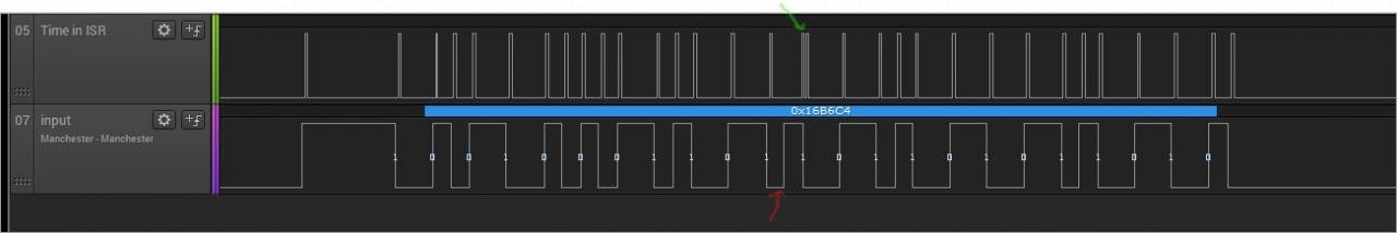

Actually I was thinking the same. @PaulStoffregen: any idea which high priority (probably prio 0) interrupt runs for about 400-800 µs? It seems to be related to the CDC interface. But the only USB interrupts I see are IRQ_USB1 and IRQ_USB2 which both have a priority of 128 and should easily be interrupted by the edge interrupt which runs at priority 32. (Setting it to 0 doesn't help)
Here an example:
The interrupt should start at about the red arrow. It actually starts some 500ns late which is after the next edge and thus generates a timing error. It works correctly for 10th of thousands of edges but sometimes it happens. Not printing to Serial but to e.g. Serial2 seems to fix it.
Edit: could also be that something lower prio interrupt disables interrupts in its ISR somewhere

Disabling interrupts does not disable peripherals. The peripherals continue to operate and set event/interrupt flags, but interrupts are "masked", so the CPU does not process the event/interrupt until that mask is removed. With respect to reading a quadrature encoder, the quadrature counting goes on as normal regardless of whether interrupts are enabled or disabled. Whenever you get around to reading the running quadrature count, it will be correct. Be careful, though, because if your design is based on reading the quadrature count at precise intervals and then computing frequency or speed as counts/time, disabling interrupts will reduce the accuracy of the frequency or speed calculation by causing jitter in the time between reads. The same thing is true of serial. The peripheral continues to work while interrupts are disabled. As long as the disable time is short, where short means less than a single byte time, then no bytes will be lost. If the UART has a hardware FIFO, and there is room in the FIFO, then the interrupt disable time can be longer without losing data.
Here an example:

Even 100ns seems strange maybe Paul knows what's running there with high priority or disabling interrupts when serial printing.
I took the 100 ns to be minimum variation in response to interrupts, as opposed to interrupts being disabled. Will be curious to hear more on this. It's important to me to know how to avoid all disabling of interrupts if necessary. For example, T4 hardware serial has some disabling of interrupts, whereas T3 does not.

I see no glitches either! Would love to know why
As shown in the LA trace in #57 the glitches come from a late (~500ns) invocation of the ISR, probably due to some other high priority interrupt running at the same time. If the ISR is invoked after the counter detected the next edge, one edge is lost or at least completely wrong.
The DMA transfer of the capture register to the ring buffer is (usually) not delayed that much (even if interrupts are running). So, the chance of skipping one edge is much smaller.
Hope that helps
