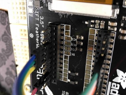

I'm having a problem getting the STMPE610 touch controller of the ADAFRUIT 3.5" TFT Feather wing to work with the Teensy 3.6. The TFT HX8357 display is working properly.
The sketch uploads with no error messages. With the program running the serial monitor reports the STMPE610 on-line, however a touch is never sensed and reported (x, y and z data). I've looked at all SPI signals, TFT CS, TFT DC and STMPE CS with my o'scope. All signals change state and voltage levels seem appropriate for 3v logic.
Any ideas would be appreciated.
Rick

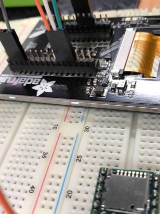

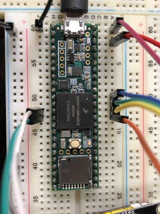

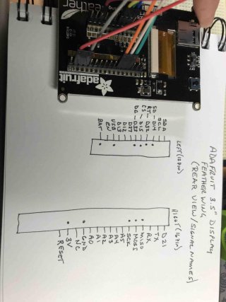

Pics of the Teensy/TFT wiring refer below
The pinout for the ADAFRUIT TFT Feather wing is a bit tricky, the link refers https://www.adafruit.com/product/3651
Basically in this application only the MISO, MOSI, SCK, GND, 3v, RT, CS, DC, USB are utilized. The below pic refers.
