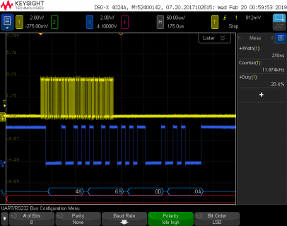

To answer your question: no, you shouldn't lose Serial1 when WS2812Serial uses Serial4. Not due to memory sharing or any other reason. They're supposed to be independent and able to work simultaneously, without any resource conflict.
Normally I don't investigate unless you provide a complete program I can copy into Arduino to reproduce the problem. I did copy your code into Arduino, but it's not a complete program which compiles, much less gives me a way to quickly reproduce the issue.
In this case, I decided to write a quick test to check. Here's the code I tried.
#include <WS2812Serial.h>
const int numled = 5;
const int pin = 32;  // Serial4 on Teensy 3.5
byte drawingMemory[numled*3];
DMAMEM byte displayMemory[numled*12];
WS2812Serial leds(numled, displayMemory, drawingMemory, pin, WS2812_GRB);
  leds.begin();
  leds.setPixel(0, 0x5AA566);
  leds.setPixel(1, 0x88BBC6);
  leds.setPixel(2, 0x123456);
  leds.setPixel(3, 0x789ABC);
  leds.setPixel(4, 0x00FFF0);
  Serial1.begin(115200);
  leds.show();
  Serial1.println("Hi");
  delay(10);
When I run this on a Teensy 3.5, here are the waveforms I see on pins 1 and 32.
Seems pretty clear that WS2812Serial is able to transmit data on pin 32 (Serial4) while Serial1.println() is able to send a string on pin 1.
This doesn't necessarily mean there isn't an unknown bug lurking. But hopefully this can give you an idea of the sort of code you need to post, if you want me to investigate further. Please, trim it to the smallest code which reproduces the problem, and double check that the code you post here really does compile when copied back into a blank Arduino window and really does reproduce the problem.

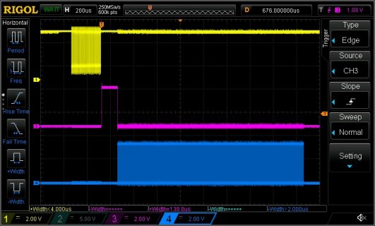

Here is a scope shot
Ch1 - Serial data from Master to Slave
ch3 - pin4 of slave showing time spent in serial update function
ch4 - pin32 light data output
Everything here is working as intended.
There are some inherent issues that can come about with the way i have designed the serial protocol, but in this simple form it is working. I just did it this way to more closely emulate the original software and what i was trying to accomplish.
So it looks like there are no issues with the WS2812Serial and using Serial1.
Thank you again for the quick response and example you provided.
