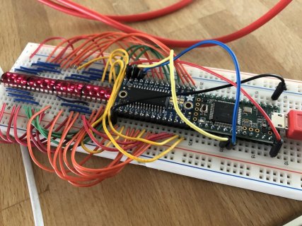

Hi, I have some trouble getting serial to work in this project.
What do I want to achieve?
I've hooked up 64 x HP QDSP-6064 bubble displays to 16 x Adafruit HT16K33 Breakouts. (Actually only to 8 for now, still waiting on a delivery).
This results in a "display" of 32 by 8 7-segments.
This project by Kris Winer HT16K33_Display_Driver helped a lot.
Now I want to send live video data from a processing sketch to the arduino sketch and display it.
It's basically D.I.G.I.T. by Teehan+Lax Labs, but much smaller in size. Here's a video of it:
https://vimeo.com/79332227
And here I'm struggling on the arduino side with the serial handling.
I've looked at OctoWS2811 example movie2serial.pde and VideoDisplay.ino.
How can I access the buffer with the 256 byte values?
And do I need to convert them back to HEX?
int segData[32*8]; //is this the right size?

One more side question: as I need 2 I2C ports for the 16 HT16K33's I would like to do something like:
#include <i2c_t3.h>
#define WIRE0 Wire
#define WIRE1 Wire1
i2c_t3 i2cports[] = {WIRE0, WIRE1};
But it doesn't seem to work.

This is how my prototype looks like. Only 1/16 of the total project. Yes, it's a lot of wiring and soldering.
