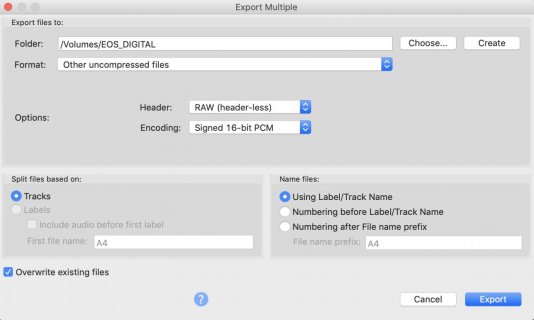

* I tried first with the playSdWav object but it felt more flimsy and tended to break more easily.
I converted the files from wav to raw with Audacity.
Any suggestions on how to tackle this matter?
