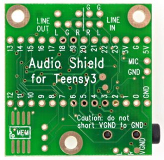

I am new to the teensy so this may be a simple question. I am attempting to record from a DC power supply (just to make sure it is working) to get a test signal. I have the power supply connected to pin 17 of the teensy. I'm having a hard time figuring out if this is the right pin to connect to. I am fairly confused about the line: sgtl5000_1.inputSelect(AUDIO_INPUT_LINEIN);
I'm not sure what AUDIO_INPUT_LINEIN is referring to. Could anyone help me out with figuring out which pin I should hook the signal generator up to to record?

Line in is on the audio shield. Upper right center on the picture.

Thank you for the response. This worked! This leads me to another question. I am now testing both of the 2 input signal pins that are there. Only one is working. Both pins have wires soldered to the pin and the respective ground pins. Is there a way where I could use both those channels simultaneously to record? Note my code above where I am recording from AUDIO_INPUT_LINEIN. Would I have to change my code to be able to recognize both those signals? Or is this not supported OR could there be something wrong with my soldering/hardware? Thanks!
The connections are only using the left channel (0).
Use this connection to route the right channel from the line-in to the right channel output:
AudioConnection          patchCord4(playRaw1, 1, i2s1, 1);
To record, you'd need another queue:
AudioRecordQueue         queue2;
and add code in startRecording to start the queue - queue2.begin();
Then modify continueRecording so that it reads one buffer from queue1 and one from queue2 and then interleaves their samples into the buffer.
Or you can create a mono output by averaging the samples in the two buffers.
Pete
