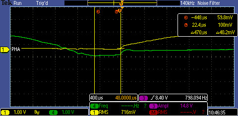

Hello,
I have a Teensy controlling an H bridge driver board I designed, which drives a linear motor. The board is used in production for burning in the motors. I'm having some trouble with the code, I'm getting significant delay (off time) when the bridge switches. The frequency of the motor is 95 hz, which gives around 10ms for one complete sine wave cycle. I'm getting between 200-500 us delay when the bridge switches. I'm using 8 bit PWM to generate the sine wave, and an IntervalTimer to trigger clock cycles, where the PWM is updated from lookup table values. The delay during the bridge switch is unacceptable for my application, so I'm looking for some pointers on how I could implement the code better. I'm baffled as to why its behaving this way. I've checked the FET drivers and FETs with a scope, the delay is from the Teensy, not the drivers or FETs. Here is a scope shot of what it looks like when the bridge switches:
The code for the sketch is here:
Here there is also code for a rotary encoder, which controls one of the Teensy DACs. The DAC provides feedback to a switching supply to control the bridge voltage. I have tried removing the Encoder code and it had no effect on the bridge timing. If I place the pin writes withing the timer ISR, the bridge delay improves to only 200 us, but still to much. Thanks for any help!!

It might be good if you told us what the traces in the scope shot are along with the horizontal scale. Also, perhaps provide a schematic or block diagram. And, a clear drawing of what you want the traces to look like. Oh, and what Teensy board?
