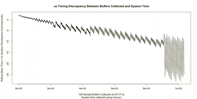

OS: Windows 10
Problem: Heteroskedastic divergence between implied audio input buffer time and system time. I'm trying to figure out how to keep exact time from the buffers that the Audio library is reading from the ADC. However, adding up the total number of read buffers produces an increasing discrepancy over time with the system time obtained by turning off interrupts and calling micros(). The picture below is the 1s rolling mean of the difference between the implied buffer time and the system time since the beginning of the program. I subtracted the first value of the difference from all subsequent differences--the system time includes all of the setup time and comes out to ~700,000 microseconds on the hardware that I'm using.
There is also a small drift that happens every 64 buffers collected that I've added a correcting factor for, but that's not nearly as big a problem as the increasing variance between micros() and the sum of the buffer lengths as time goes on. It looks like a kind of accumulating error to me, but I have't been able to find an accumulating error in my code. I was wondering if anyone else has encountered a similar problem?

  bufferTime = (buffsRcvd + availableBuffs) * (2901.37588685);
  noInterrupts();
  realTime = micros();
  interrupts();
  // sixtyFourBuffCnt is a correction factor for a timing discrepancy I noticed happening every 64 buffers of 128 samples in the output. The 2.7195 number is an eyeballed estimate from watching
  // the data scroll by on the serial monitor, but as you can see from the picture, it's a slight overestimate, amounting to ~20 microseconds of difference after 10000 samples.
  diffRealTimeAndBuffTime = (realTime + 2.7195 * sixtyFourBuffCnt) - bufferTime;
  Serial.println(diffRealTimeAndBuffTime);

I should have mentioned that this behavior is similar on the Teensy 3.1/3.2 that the Audio shield sold here comes mounted on. I had hoped upgrading the processing hardware would resolve the issue, but it did not. Similar captures of this data from the board are also uncorrelated (i.e. computing the cross-correlation between a sample collected from the first five minutes the board is on, resetting the board, then collecting the first five minutes after the reset) to a very high degree at both large and small windows. The maximum cross-correlation was ~0.05 and was mostly smaller than that.
I still get a delay of about 1/3 of a microsecond per buffer, but removing the floats entirely leaves the error constant and I'm quite able to model a way to remove that error. We can consider this topic closed!
