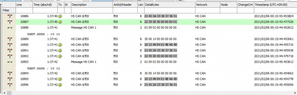

I m try use isotp for requesting from ECU
But looks need make some changes
I mean about 30 00 00 00 00 00 00 00 msg
Its working flow (not isotp)
And its form isotp
So, my question - possible add 30 00 00 00 00 00 00 00 msg after ECU answering?
May be possible add manually configurated for the msg

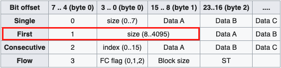

You mean have it send after the response? You can do that from FlexCAN_T4 callback if you see your request and send it. Then isotp callback will give you the buffer after
If your talking about the 3rd byte 0xF, thats the separation_time, if you don't want any, set it as 0.
0xF means 15ms per next flow frame. If your bus is high on traffic, or you lack mailboxes, or your project code is plain slow, or you are polling mailboxes, thats about the only time separation_time is needed, to keep up and not loose sequential frames. Frames out of sequence (which can happen in non-FIFO mode (all mailboxes can receive in any order)), will not collect a payload. If you have 64 mailboxes set to catch all and just 1 frame is out of order, the rebuild of isotp frame is aborted. In that case separation_time is useful to use, since the CPU can sweep the mailboxes within that timeframe.
Wouldn't make sense to automate a flow control frame in a library, since that is user specific. However, i should add auto abort eventually, if an out-of-order frame is captured, to tell the host to abort sending remaining frames, which makes better sense
Well if we take this info as example:
  can0  7DF   [8]  02 09 02 00 00 00 00 00
  can0  7E8   [8]  10 14 49 02 01 33 46 41
  can0  7E0   [8]  30 00 00 00 00 00 00 00
  can0  7E8   [8]  21 44 50 34 46 4A 32 42
  can0  7E8   [8]  22 4D 31 31 33 39 31 33
You'd make a request to from loop():

Then in your FlexCAN_T4 callback (not isotp):
  if ( msg.id == 0x7E8 && msg.buf[2] == 0x49 && msg.buf[3] == 0x02 ) {
    CAN_message_t flow;
    flow.id = 0x7E0;
    flow.len = 8;
    flow.buf[0] = 0x30;
    flow.buf[2] = 0xF;
    Can0.write(flow);
That should automatically request flow control based on the info posted above
