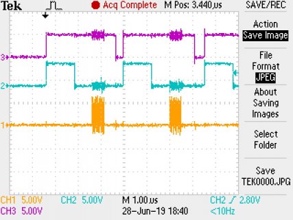

I am working with an ADC that has max sampling rate of 500kHz but using Teensy 3.5 the maximum I have been able to achieve is 300kHz. There is a ~1us delay between the data ready signal going low (blue trace) and the clock to read out the data starting (Yellow trace). Also another ~.75us delay after the clock has finished and the interrupt returns to the main loop to start the next conversion. I have attached screen capture from scope and code below. I assume there is some overhead in the beginTransaction() and endTransaction() commands, is there anyway to reduce these or is entering and exiting the interrupt likely accounting for more of the delay? I commented out the SPI.usingInterrupt() and the frequency increased by approx 20kHz.
Any help on how to reduce these delays would be much appreciated.

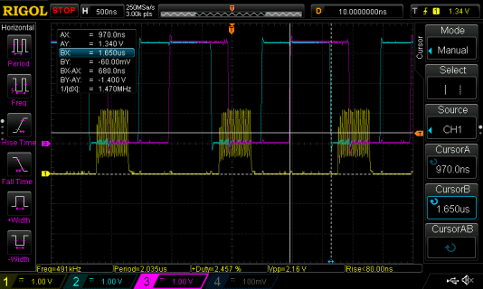

You need to remove the heavy lifting out of the ISR. With only one SPI device, you can just do SPI.beginTransaction() once. You can also use digitalWriteFast() to save a few nanoseconds. Using String variables adds overhead. I have a while(1) in loop() to avoid event-checking overhead of loop(). I have rewritten your code for my testing with a 500 KHz PWM signal (jumper pin 23 to pin 7) to indicate "data ready" for SPI. (Also most SPI devices enable transfer by pulling CS pin LOW. What is the ADC device you are using?)

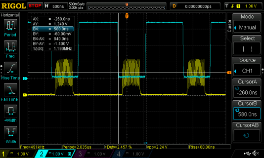

with scope i see 500 KHz sample rate, duration of CS LOW event is 840 ns (blue). SPI CLK (yellow) is 30 mhz, and 16-bit transfer takes 533 ns.
(it works for measurement purposes with no SPI device attached)
The ISR latency from when PWM (purple) goes high til CS (blue) is pulled low is about 680 ns, so a sample takes about 1.51 us, and max sample rate would be 667 KHz.
comparisons with Arduino 1.8.8 and 1.47 beta4
T3.5@120mhz SPI 30 mhz  CS low 824 ns, ISR 700 ns, total 1.53 us  (max 654 Ksps)
T3.6@180mhz SPI 30 mhz  CS low 788 ns, ISR 480 ns, total 1.28 us  (max 781 Ksps)
T4B2@600mhz SPI 37.7mhz CS low 736 ns, ISR 220 ns, total 0.96 us  (max 1.04 Msps)
