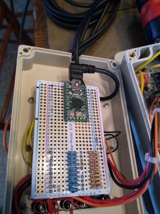

I have a Teensy 2.0 mounted on a Perma Proto board with 10 voltage dividers. Those are fed by 12 volt signals into 10 terminals mounted on top of the box containing the Teensy and other components (see images). 12 volts comes into the box, and is converted to 5 volts for the Teensy and a dual relay board.
The Teensy just waits for instructions from the PC, and if it receives an ASCII "1", it activates relay #1, an ASCII "0" deactivates (opens) relay #1, and the only other command is an ASCII "9", which starts the reading process. Relay 2 is activated, it waits 1 second for the sensors connected to settle, and the 10 GPIO inputs are read and accumulated, and the result fed out the serial port to the PC. Very simple, yet it hangs fairly often. If the Teensy loader program is running, I can press the reset button on the Teensy, and it reloads and reboots. Otherwise, I have to kill the power from both the USB port and the 5V regulator.
This is for a production line, and simply cannot hang like this. I've used Teensy's for a long time and cannot figure out why it hangs. If anyone has any ideas what I'm doing to cause this, or if there is a better way to get data to and from the Teensy 2.0 and the Windows 10 PC, please let me know.

Looks like the wires between the Teensy and relay board are permanently soldered? Any way you can disconnect the relays but still run the same code on Teensy? Then you could see if the crashing still happens without the power consumption and other electrical activity of whatever those relays control.
Or if you can't disconnect the wires, maybe try the same code with the digitalWrite that turns on the relay commented out. Can Teensy do everything else successfully? My point is the problem may be a bug or oversight somewhere in the code unrelated to the relays and power switching. Or it might only happen if the relays are connected and switching. Knowing which of those might help to at least focus your effort to the right place.

Thanks for the response. I disconnected the relay signal wires and made the changes KurtE expressed. The board that the Teensy is soldered to connects to the box through these little lever connectors you can see in the previous picture. So I can just pull up on the lever and take the wires out.
I did that with the relay signals, and have run the "9" command over 200 times, and have not been able to get it to crash. It looks like that is where the problem is.

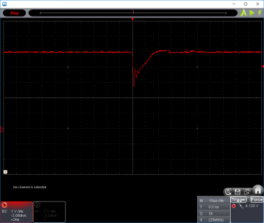

I hooked an oscope to the relay signal line, and it looks fine. Then I hooked the probe up to the Teensy's power input. I keep getting this when the relay switches on.
Do you think that 2 volt glitch could cause issues like I'm seeing? If so, maybe just a capacitor on the 5 volt supply would fix it. What do all ya'll think?

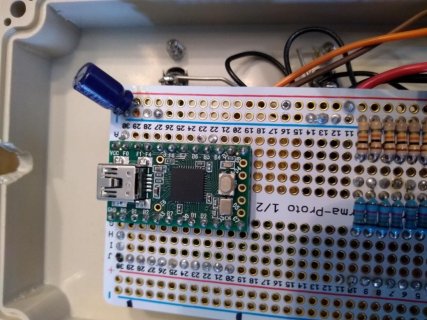

Update - I had a 47 uF, 6.3 V electrolytic capacitor left over from another project, and I held it right next to the Teensy 5V input, and could not get it to fail. I'm getting my solder iron out to attach it securely. I'll let you know after more testing. Thanks for all your help!
If problems still happen rarely, maybe also try adding a 1N5817 or similar schottky diode between the incoming power and the capacitor & Teensy. The diode will allow the current to come into the capacitor, but not flow back out when the power supply source drops momentarily.
Of course, a more capable power supply might also be something worth considering. Or if this is running only from the USB power, maybe a dedicated power source known to be sufficient for the relays and other hardware might be the more proper solution.
It has now run for several hours, accessing the sensors by turning on the relay over 1300 times, with no errors. I'm calling it good. Thanks to both of you for all your help!
