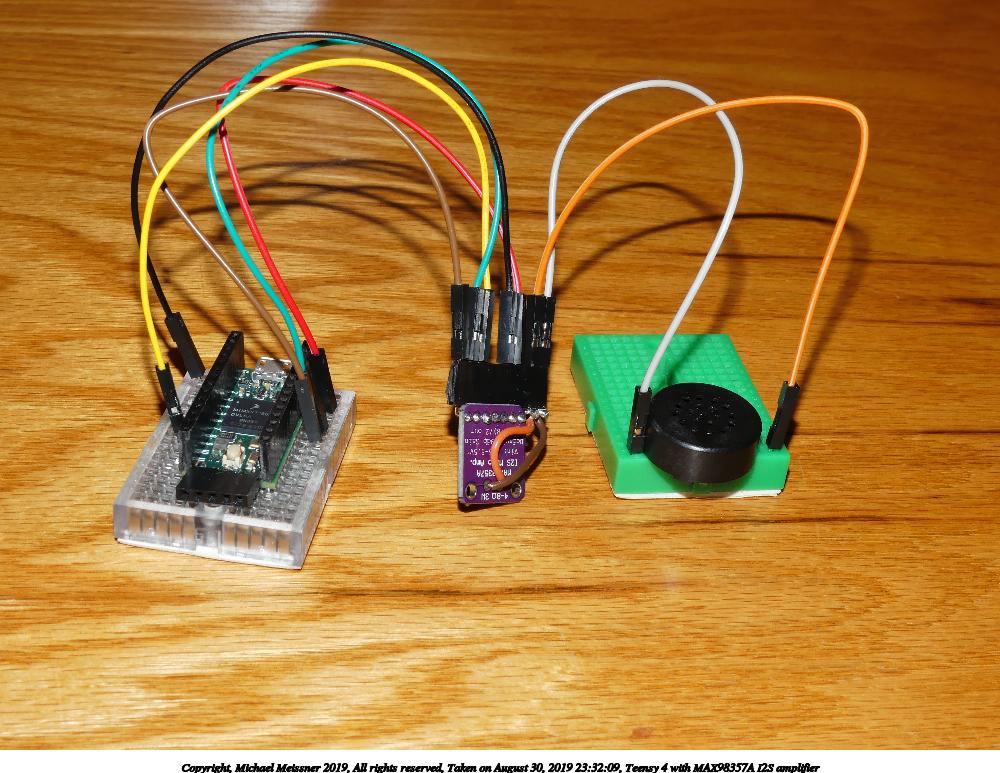

    The Teensy 4.0 does not have an onboard DAC, though if you aren't using a SPI device, you can use the MQSL and MQSR pins (pins 10 and 12).
    Instead of a DAC, it is probably best to use I2S output and do digital sound output. I had a thread about doing sound output without using the audio shield that gives two sample sketches, one using a cheap I2S amplifier to a mono speaker (or possibly I2S amplifier to stereo speakers), and also using MQS to output sound:
    Here is the I2S mono amplifier that I used, plus another I2S board that can do stereo (I haven't tried the stereo board yet):

    Somebody with more depth in the sound processing area will have to answer most of these questions. I believe (but I certainly do not know) that everything wtihin the Teensy is handled in a digital fashion (i.e. I2S).
    I believe the PT8211 kit will not work with the Teensy 4.0 if you attach it directly, due to the pinout differences for sound between the Teensy 3.2/3.5/3.6 and Teensy 4.0. Like the larger audio adapter, you would likely need to use jumper wires, etc. to reroute the pins.
