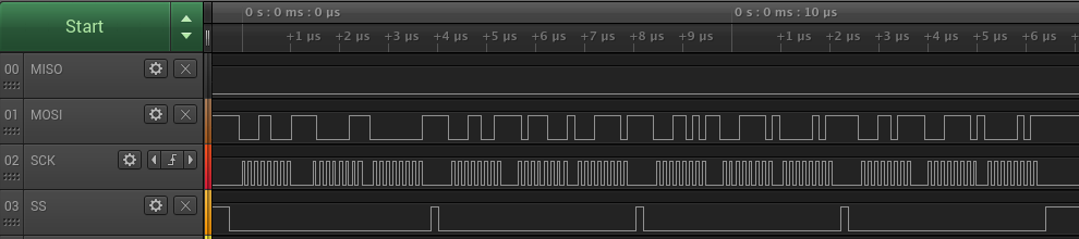

Teensy 3.6, So the deal is I'm using a DAC where the data format should like like this (below), This is just from polling the the spi bus the old fashioned way.
Meaning I need to do...
  1. Set CS low
  2. 3bytes DMA transaction
  3. Interrupt
  4. Set CS high
  5. GOTO step 1
Is there a "simple" way to do this with the SPI/DMA library? This is what I have so far... ( Please note spi_cb is being called by an interval timer at a set cadence, when I want this 12byte sequence above to happen.

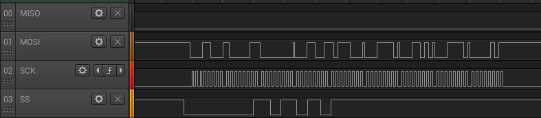

It gets me something like this...
So the dma is interrupting when it's transmission is finished, which isn't really what I want, I want an interrupt when the SPI is done three transmissions. If doing this with DMA isn't possible, it might even work if I just interrupt every SPI byte transmission, and then deal with the CS/timing every byte.
