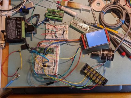

I am using QuadEncoder_interrupt_pins. I have changed my HW to use the same pins as the example. Have a couple of questions.
1. In the library, I see that the index counter is defined as uint32_t, but in the running code, an underflow (negative index count) is 16 bits. Why is this? For a motor spinning at 3600 RPM, this would mean rollover ever 18.2 minutes. Is there a way to modify this easily?
2. Is there a way to print out the quad encoder configuration. There's no easy way to determine if the defaults chosen are applicable to the user. I see a method defined, but I don't know how to use it. A minimal example would be helpful. This is not meant as a knock, but if would be really helpful to new users, if there was more documentation, either in the source, or in a wiki. The examples given do not seem to clearly showcase many of the abilities of this library, and it is a bit confusing, at least to me.
3. What is the difference between home and index in a practical sense?
If I were to use this library, I'd like to understand it's practical limitations. What happens when there is a position over or underflow? The HW register is limited to 32 bits. For a motor running continuously, (at high speed) rollover could occur in 19 hours or so, if starting from zero. Practically, I won't run at max speed, but I'd like to be able to handle the situation. There are interrupts defined, but they are disabled, and there is no code. From a practical sense, what might make sense?
My target application is an electronic leadscrew for a lathe, which could be used for cutting threads. I need to work through many of these issues, so that I'm not surprised, or at least I don't cause severe mechanical damage. The main motor is 2 HP, so if things crash, it would not be a good thing.
Thanks for your help.

This is sort of just trying to understand behaviorally what is happening. As expected, the index counter stays at 0. The position HOLD revolution value increments. The first case is at:
Current position value1: 114
Position differential value1: 1
Position HOLD revolution value1: 0
Index Counter: 0
Current position value1: 115
Position HOLD revolution value1: 1
Index Counter: 0
The second increment is at:
Current position value1: 2246
Index Counter: 0
Current position value1: 2247
Position HOLD revolution value1: 2
Index Counter: 0
I do not understand what controls the transition point. I have a 1024 point encoder. So there should be 4096 edges in one full rotation. What is Pulse HOLD revolution doing?

Still hard for me to comprehend what can cause this kind of output.
Current position value1: 4377
Position differential value1: -1
Index Counter: 0
Current position value1: 4376
Index Counter: 0
Index Counter: 0
Position HOLD revolution value1: 31
Index Counter: 0
Position HOLD revolution value1: 30
Index Counter: 0
Doesn't feel causal for the Pos HOLD rev value to go from 2 to 31 with a position value from 4377 to 4376!
This makes me feel something is wrong, really wrong. It may not be, but it doesn't make sense to me at all. This is with a real rotary encoder, sitting on my desk.
See the printConfig() method.
Maybe I'm a dunce, but I don't know how to invoke it. myEnc1.printConfig(); Gives me a compile error. Error is "no matching function for call to 'QuadEncoder::printConfig();'
Ah. I have a library problem.
Arduino: 1.8.19 (Linux), TD: 1.56, Board: "Teensy 4.1, Serial, 600 MHz, Faster, US English"
QuadEncoder_Interrupt_pins__bdl: In function 'void setup()':
QuadEncoder_Interrupt_pins__bdl:23: error: no matching function for call to 'QuadEncoder::printConfig()'
In file included from /home/me/Arduino/QuadEncoder_Interrupt_pins__bdl/QuadEncoder_Interrupt_pins__bdl.ino:1:0:
/home/me/Apps/arduino-1.8.19/hardware/teensy/avr/libraries/QuadEncoder/QuadEncoder.h:196:7: note: candidate: void QuadEncoder::printConfig(QuadEncoder::enc_config_t*)
  void printConfig(enc_config_t *config);
/home/me/Apps/arduino-1.8.19/hardware/teensy/avr/libraries/QuadEncoder/QuadEncoder.h:196:7: note:   candidate expects 1 argument, 0 provided
Multiple libraries were found for "QuadEncoder.h"
 Used: /home/me/Apps/arduino-1.8.19/hardware/teensy/avr/libraries/QuadEncoder
 Not used: /home/me/Arduino/libraries/Teensy-4.x-Quad-Encoder-Library-master
option enabled in File -> Preferences.
What is a good way to fix the libraries? And how is the method invoked?
edit: Apparently this is a known Arduino issue. How do I find out which is more current?
It gets invoked this way:
 myEnc1.printConfig(&myEnc1.EncConfig);
