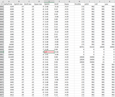

Now let's come to the problem. When capturing data and writing it to the SD Card sometimes a variable of the calculated GyroValue overflows (not the Raw Gyro value) and that of course leads to a high PID output and lastly to a crash.
Again, this only happens when I capture data. After some hours of debugging I found out if I disable the SBUS receiver and set the receiver values to constant values this error doesn't occur at all.
Here's the piece of code that does reproduce the error:

The loop of the flightcontroller is of course changed in order to capture 5 mins of data. A piece of data looks like this:
If you now comment out the readSBUS() function everything works as expected and you don't get any overflows.
Does anybody know why this happens and how to resolve this issue? Or am I just dump and did a mistake?
Thanks in advance, feel free to correct my bad English ;)
