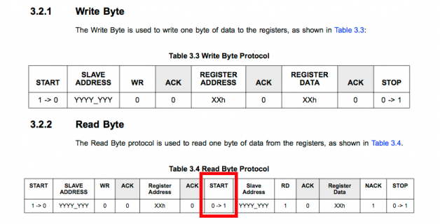

Hello,
I am trying to use the Teensy 3.6 to communicate with a bq40z80 chip from Texas Instruments. The chips is a fuel gauge / 'smart' battery management chip. A standard was developed called, SMBus that operates from the well known I2C protocol. However, it has a special start bit that is not typically used in I2C devices. Therefore, the <Wire.h> library does not work to communicate the the battery chip..
A thread here shows how they got it to work, but it uses a library that was built for AVR devices. Unfortunately I just don't think I know enough to be able to convert that to work with the Teensy/ARM platform.
I am hoping that the i2c_t3.h library can suffice. So this is the description of the SMBus protocol..
Below is my code to try and retrieve the voltage from the chip, but the result from Wire.available() is 0.

Supposedly, someone was able to use this "i2cmaster" library for AVR devices, to get the data they wanted. Below is that code.. (if I could somehow adapt this to use the "i2c_t3" instead?)
If anything, check out the last 3 functions. Particularly the lines containing "i2c_rep_start()". That seems like something I want to be able to use if i2c_t3 supports something like that

Any ideas on how to go about properly requesting data from the chip?
Thank you for any and all help! It is vastly appreciated and would make me a very happy person if I can get this working.
If someone finds this thread in the future, I got it to work just fine! There may be a few different ways to do this, but the following works for me:
This was for a bq40z80 chip
