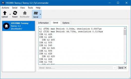

    896
    Quote Originally Posted by luni View Post
    .. I try to add the setting for the FTMs tomorrow and post an update on GitHub.
    I added the FTM_DEFAULT_PSC setting to override the auto prescaling value for the FTM timers. See here https://github.com/luni64/TeensyTimerTool#configuration for the documentation.
    You can query the TeensyTimerTool timers for their max period as shown here:
    #include "TeensyTimerTool.h"
    using namespace TeensyTimerTool;
    PeriodicTimer t1(FTM0);
    PeriodicTimer t2(TCK);
        while (!Serial) {}
        TeensyTimerTool::attachErrFunc(ErrorHandler(Serial));
        t1.begin([] { Serial.printf("ISR t1 %d\n", millis()); }, 40'000);
        t2.begin([] { Serial.printf("  ISR t2 %d\n", millis()); }, 80'000);
        Serial.printf("t1 (FTM) max Period: %.3fs, resolution %.4fs\n", t1.getMaxPeriod(), t1.getMaxPeriod() / 0xFFFF * 1E6);
        Serial.printf("t2 (TCK) max Period: %.3fs, resolution %.4fs\n", t2.getMaxPeriod(), t2.getMaxPeriod() / 0xFFFF'FFFF * 1E6);
    Which prints for a T3.2 @96MHz and auto prescaler:

    I was trying same example to check it's working on Teensy 4.0 but I am getting this error.
    'FTM0' was not declared in this scope
    I updated TeensyTimerTools to 0.1.3. Any other library still missing?

    The FTM timers are only available on the T3.x Boards. Here the List of supported timers: https://github.com/luni64/TeensyTime...pported-Timers
