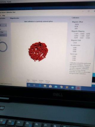

I just tried the calibration inside the car. The imu is located between the front seats of the car.
First I tried with the engine running and the result is very bad. I attach an image where you can see the values. I have followed the patterns of mjs513 used in the FreeImu wiki.

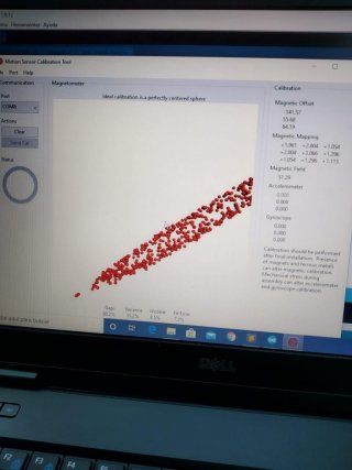

Suddenly a small sphere has been made, but the values ​​are still bad. I attach the following image.

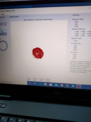

Finally I tried to do the calibration with the engine off. The result is somewhat better but impossible to send the calibration to the plate. It can be seen in the following image.

There are a couple of things to consider. Sources of interference is primary. Don't know enough about cars but I assume you are testing sitting in the front sit closest to all the electronics and the engine etc. Have you tried locating it say in the back of the car farthest from the engine etc. Basically move the imu as far away from the source of the varying magnetic field.
