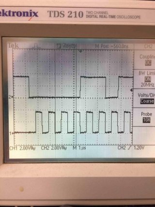

I was having some issues communicating with an ENC28J60 Ethernet controller on Teensy 4.0 using SPI.
At seemingly random intervals, the most significant bit of an octet would get transferred incorrectly, causing the controller to malfunction.
Once I analysed the SPI communication, I noticed that, if the first SI bit is supposed to be a 0, the Teensy pulls SI low on the first rising edge of the clock.
Since I have my SPI configuration set to mode 0 (which is what the Ethernet controller requires), this is too late,
because the ethernet controller will sample SI on the rising edge of the clock - right as it's in the process of switching from high to low.
Because of this, for the same byte, it sometimes reads the first bit as a 0, other times as a 1.
Curiously, this only happens with the most significant bit. All other bits correctly switch state on the falling edge.
I used the following code to reproduce the problem:
SPISettings spi0(1000000, MSBFIRST, SPI_MODE0);
	SPI.begin();
	SPI.beginTransaction(spi0);
	SPI.transfer(0x0D);
	SPI.endTransaction();
Recording the output of this program with a logic analyser shows this:
As you can see, SI goes low on the first rising edge, but after that, all remaining bits are switched on the falling edge.
The diagram below is from the ENC28J60 datasheet, which shows that MOSI already needs to be high/low before the first rising edge of the clock passes.
I am unsure what causes this, and I am wondering whether I am doing something wrong here, if I have bad hardware, or if this is a bug in Teensyduino (I am using Teensyduino 1.51 with Arduino IDE 1.8.12 on Windows).

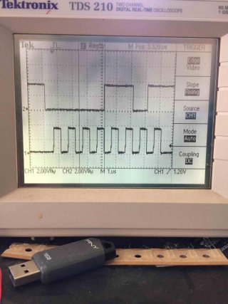

It's definitely an issue with the Teensy 4.0 Hardware or SPI Library. I ran the same code on a Teensy 3.6 at 180MHz with Teensyduino 1.51 and Arduino 1.8.12 and the MOSI signal definitely goes low about half a clock sooner on the T 3.6.
Teensy 3.6 at 180MHz:
Teensy 4.0 at 600MHz
I took a quick look at the SPI library code for the T4.0 and tried to match it up with the register descriptions, but nothing jumped out at me that would explain the timing difference. However, my understanding of the behavior of the low-power SPI on the T4.0 is far from complete!

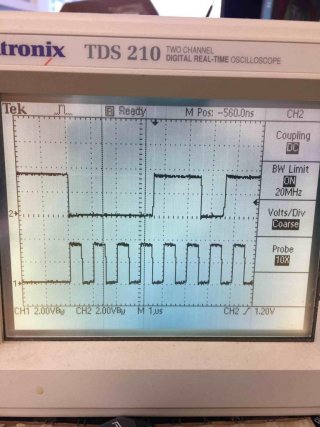

I have found that adding some PCS to SCK delay will move the start of SCK to a point after the MOSI signal is stable:

I added a large delay of 128 and it delayed SCK about 1/2 cycle. A shorter delay may be effective. How much shorter will depend on the setup time required by your SPI peripheral.
I also found that slowing the T4.0 to 150 MHz moved the SCK edge a bit without editing the source since there is a default delay of 1 clock cycle, and with slower clocks the SCK is delayed 4 times longer.
