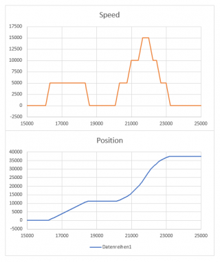

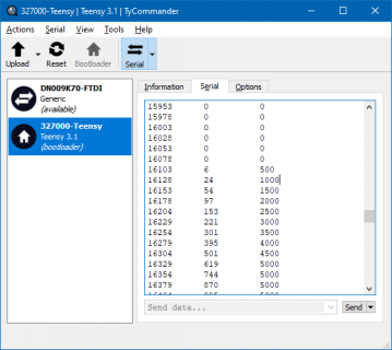

Here a working example showing how override speed on the fly. For the sake of simplicity, the example doesn't use pins for the speed control but listens on Serial for commands. It should be straight forward to translate the example to your application. The example prints current time, position and speed to Serial. I often use this to check the movement without connecting motors. It is easy to cut/paste the data from sermon to a spread sheet and display the movement.

Here the generated data
And here the movement graph
