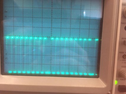

I have a very simple 3-wire (SCL/SDA/GND) connection from an Arduino Mega 2560 to a Teensy 3.2. I can send data from the Mega to the Teensy fine, but no matter what is sent from the Teensy to the Mega, the Mega receives 0xFF. I have verified that the connections are proper, and (with my trusty O'scope) verified that the signal voltage levels are correct. The scope photos below show the SCL line for the master-to-slave case (top) and the slave-to-master case (bottom). In both photos the vertical scale is 1V/cm and the horizontal scale is 20uSec/cm
I was initially using I2C_Anything to transfer data both ways, but also tried 'bare metal' byte processing by copying the underlying code from I2C_Anything - no change.

I'm sure it's something simple, but for the life of me I can't see it. Any help would be appreciated.
TIA,
Frank
