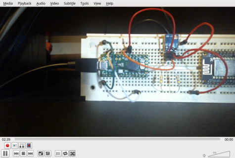

I'm trying to get an I2C board working. It doesn't. Neither do two other boards. The LC doesn't see anything on the I2C bus. I'm using the following code to test:

I have the devices connected as
Teensy LC pin 18 - Module SDA
pin 19 - Module SDC
pin 3V - Module VCC
pin GND - Module GND
I have two 4.7K pullups connected to the SDA and SDC pin from pin 3V.
To further complicate things, I also attempted to use both an ESP32 and ESP8266 to connect to the I2C devices with similar results.
I also removed the pullups
All parts were in their static shielded envelops before they were removed and tested.
I'm at a loss and thought this forum has some of the brightest folks I know, so here I am.
Any ideas?
Thanks,
Jim
The colour bands on the resistors in the photo do start with 4 and 7, but the third band doesn't look red (4.7k). It looks more like yellow (470k).
Pete
That's pretty close to the right answer. It turns out that the drawer that contained those 4.7 Ohm resistors was marked as 4.7 K. I didn't look at the colors. My eyesight isn't what it was when I was young so I have to use a magnifier to read color codes these days. That's a good excuse anyway.
Thank you all for the help.

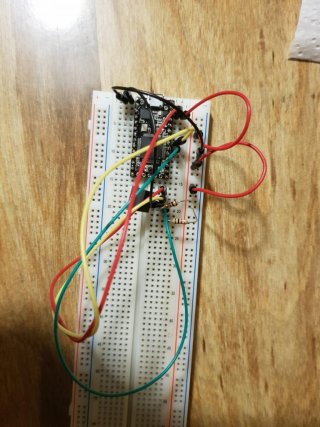

Hello,
it is very difficult to see in the photo, but at the soldering points of the teensy it looks as if there is a short circuit between D18 and D19 (SDA, SCL).
I found the problem! You won't believe this but the culprit was actually the green wire, it was defective. I couldn't find any physical damage to it but the continuity tester showed it was open.
I replaced the wire and the I2C detector immediately found the TMP102.
Thanks everyone for your help!
