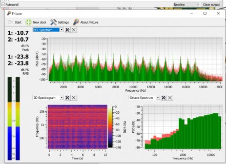

The resultign spectrum on the USB audio looks like:
Does it looks like one would expect?
I was expecting much sharper peaks as this method (USB audio) as far as I got is using the digital transmission with no EM noise or speaker distortions...
Thanks for any help or advice on how to generate the cleanest possible sound.

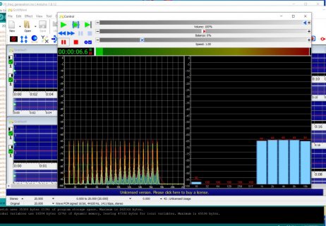

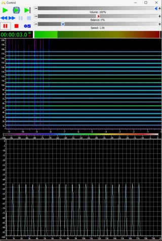

I ran your sketch on a T3.6 with Rev C board. Using a Win10 64 Pro PC with Arduino 1.8.12 and TD 1.52 B1.
I generated the attached spectrum using Goldwave which reads the audio directly from the Teensy USB.
When Goldwave first starts recording, the peaks widen briefly (which shows as the vertical lines in the upper spectrogram) - maybe this is a buffering problem between the Teensy and PC?. But then it settles down and produces a solid, unvarying spectrum.
Pete

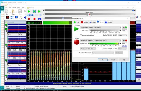

Thanks for the investigation. I have tried to install the Goldwave but (probably due to bad configuration) still see a bumpy spectrum, like if there are constant transitions between the one You show and the one in the initial post.
How long have you registered until it did settle to the nice spectrum? Because on 20s registration is like it sometime starts ok but then I see again the noisy picture.
I use TD 1.51, Win 10 64Bit and Arduino 1.8.12.
It seems that I see a very drastic difference if I change in the Device property the the volume.
at 0db

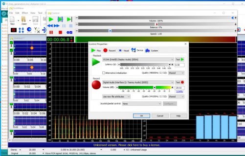

at -30db
Still is strange the bumping spectrum.
