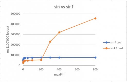

Some time ago I did a T3.2 project which involved a PID regulating the angles between two motors. Since I assumed that the trig functions will do some modulo 2PI internally I didn't bother avoiding large arguments. At the end I found out the hard way that the trig functions get extremely inefficient for large arguments.
Seeing your post I remembered this and did a quick experiment to find out what happens if one reduces the max angle. Here my test code. I manually increased maxPhi from 1 to 800 and plotted the results

Results:
maxPhi  double  float
1	45461	26249
2	52708	31658
3	58923	36152
5	65796	41319
10	70930	45083
20	73458	47035
50	74956	48188
100	76304	50921
200	76996	53987
300	77272	230641
400	77418	320156
800	77712	455706
Graph
For maxPhi below some 250rad everything is fine. Then the efficiency of the sinf algorithm decreases dramatically. So, looks like the GCC team improved the sinf algorithm sometime in between the compiler versions.
Is there a way to fix this without installing a new compiler?
You can always make sure to do a modulo 2PI to the argument, that should fix it.
That looks much better :) Thank you very much.
