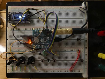

I've been having a great time with my Teensy 3.6 / Audio Shield and sending FFT data to an OLED display.
As the whole thing is currently on a breadboard, one thing I wanted to do was make the Teensy into a USB host.
This way I can use my durable €20 HID MIDI DJ controller and hand that to my two-year-old when she wants to play with the synth instead of her pulling out components all over the place :)
I already had the Analog inputs -> Synth -> FFT -> Display part working, and last night I managed to get the USB host working too.
However the update rate is painfully slow, even keeping calculations to a minumum. When I turn a MIDI knob it can take a few seconds for the synth parameter to catch up. It seems to slowly go through every value from the original position down to the target position, even if I move the knob quickly.
When I run the USB Host demo it outputs values to the serial port in realtime, with no delay. Similarly the Audio Shield sketch is really responsive when twiddling knobs.
It's only when I combine the two that there's an issue, which makes me wonder: am I simply asking too much of the Teensy 3.6?
I do have a 4.0 on the way so can test it when it arrives, but that might take a while...
Here's my code - would appreciate it if anyone notices something glaringly wrong!

I'd say it's because you're refreshing the whole displays in every loop. The display is really slow. So you may want to modify the code. And yes, a 3.6 is fast enough.
Thanks for the quick reply :)
The thing is, the same code minus the USB stuff works fine, no delays at all - and the time for the loop to complete stays the same, somewhere around 56ms/57ms:

This OLEDFeatherWing has a SSD1306 display. The current code just blocks the execution of loop() while the display is being refreshed. Audio is not affected, because it runs on interrupt.
It may get better, if you execute the "//Draw a frame"-section maybe 4 times a second. Ask for millis(). Or at least, move this part up into the if(){} of "//Update data every 20 frames...", so the display is refreshed only every 20th run.
Also, you are drawing first the frame and then check for new data. I'd first check for new data and draw a frame only if new data are available.
Seeing what FrankB saw - this is updating the display each time - but FFT data only updated when .available.
T_3.6 loop() should run up to a MILLION times a second - allowing USB Host processing in good time.
The display update is perhaps 56 ms and that is limiting the loop cycling to 17 times per second.
So YES this " // TODO: should this be higher?" code should be higher and the data arrays should only update with new data .available and the display should be updated:

THough the FFT update it seems updates faster than 17 times per second - reading the @Deleted User crosspost - an overt limit on display update should perhaps be done - even dropping to 10X/second will allow many more loop passes for processing.
Ok, I think I'm starting to get it - thanks so much to you all for this help! It's late here so I'll make some changes in the morning and report back :)

It works!
Code below. It didn't seem to make a noticeable difference whether I put the FFT.available code inside or outside the loop that runs every 100ms; either way the loop now runs somewhere ~1ms :)
