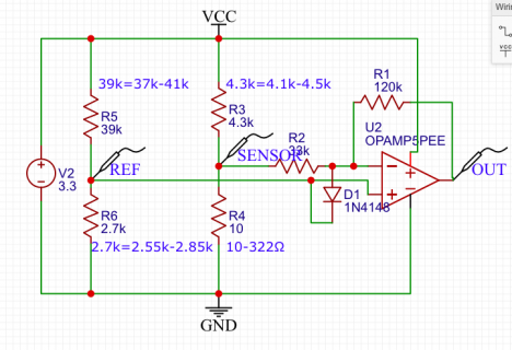

I'm back to electronics after years of inactivity in that field and I might be a little rusted, so I'm looking for a little help to check my work.
Here is my problem to solve:
- Reading 10-322 / 10-180 ohms automotive resistive sensors (Temp/pressure)
- Lowest possible cost (only basic components for no "extended parts" on production line of the PCB)
- Protected
- SMT

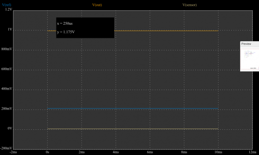

Here is the approach I tried to build (cf schema and simulation attached):
- LM324 cheap Op Amp (7cts for a quad package) used as inverted amplified in single supply (3.3V)
- Inverted amplifier for virtual ground with low current, Basic reference voltage with divider
- Voltage Divider with sensor as lower part of it
- Protection diode basic (no Schottky) from sensor input (middle of divider) to reference voltage instead of the classic Vcc so that it triggers way before VCC = 3.3V (reference is in the 0,230-0,260V)
- Depending on luck with resistors, output range goes from 50mv to 1,1V down to 350MV to 890MV in narrowest case
- Teensy 3.6 ADC on 1.2V reference, in worst case more than half of the range is still usable: much more than what I need (1000 values would be enough, that leaves 4096)
Simulation at all min/max values of 5% resistors shows Vout always in 50mv - 1.2V range, op amp within in and out ranges. System seems to survive 90V en Sensor input.
Is there something wrong with those assumptions ? Do I miss something (or everything )
