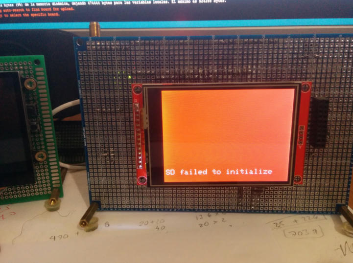

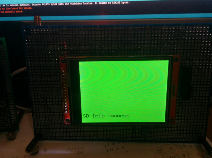

    With SD.begin()
    With SD.begin(SdioConfig(FIFO_SDIO)) or SD.begin(SdioConfig(DMA_SDIO))

    This is the setup to obtain the previous images
    tft.begin();
    //ts.begin(); // touchscreen begin
    tft.fillScreen(ILI9341_BLACK); tft.setRotation(3);
    if (!SD.begin(SdioConfig(FIFO_SDIO))) {
    //if (!SD.begin(SdioConfig(DMA_SDIO))) {
    //if (!SD.begin()) {
    tft.fillScreen(ILI9341_RED); tft.setRotation(3);
    Serial.println("SD initialization failed!");
    tft.setTextColor(ILI9341_WHITE,ILI9341_RED);
    tft.setCursor(5, 205);
    tft.setTextSize(2);
    tft.print("SD failed to initialize");
    delay(3000);
    SdFile::dateTimeCallback(dateTime); // set date time callback function
    tft.fillScreen(ILI9341_GREEN); tft.setRotation(3);
    Serial.println("SD Init success ..file timestamp callback installed ");
    tft.setTextColor(ILI9341_BLACK,ILI9341_GREEN);
    tft.setTextSize(2);
    tft.print("SD Init success");
