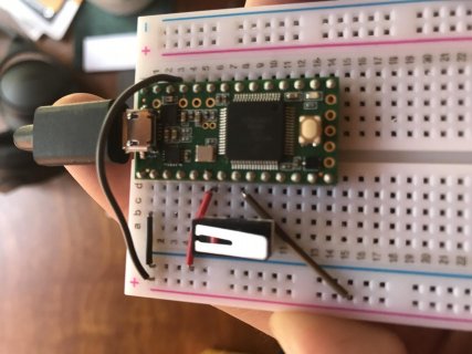

Actually, here's a somewhat interesting update:

This will print "test 1test3" on loop, until I press the button. When I press & hold the button, the LED goes off, but neither test2 nor test3 are printed. It seems like holding the pushbutton suspends the program? Is that possible? Can you think of a wiring mistake that might cause that? Thank you so much for your help!

If I don't press my button, ever 4 seconds it prints "0". If I press (and hold) the button, it stops printing until I release it. No matter what I do, I can't get it to print anything above 0. It's like it just freezes when the pushbutton is depressed. Commending out digitalWrite(13,0) doesn't do anything, so this is definitely about the input, not about the LED.
Any thoughts?
That last sketch works for me.
Take a photo of the wiring and the board and post it here.

OK. I think your wiring is wrong. You have pin 4 wired directly to ground and one side of the switch. The other side of the switch is apparently wired to pin 6 and 3V3. I think what that will do is short the 3V3 regulator to ground when you push the switch.
Pin 4 should go to one side of the switch and the other side of the switch goes to ground. No other connections. To do that you will have to put the switch to the right of the Teensy and use longer wires.
