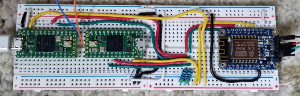

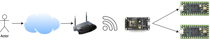

I am trying to set up a simple project with a Teensy 4 and an ESP8266 that communicate over I2C to allow some LEDs to be controlled by the Teensy. The rough idea is something like this:
Where the two Teensy's at the end are controlling some LED strips via WS2812Serial based on the commands they receive. After failing to get anything working I broke the project down into the smallest test setup that I could and it looks like this (although a Teensy 4 instead of a Teensy 3.1):
In this configuration I am unable to get the two devices to talk to each other in either master/slave or slave/master configuration. If I set up one as a slave and then use the scanner I get back 0 devices. Curiously, if I replace the Teensy with an Arduino Uno OR I replace the ESP8266 with an Arduino Uno then they are able to communicate without any issues. At this point I feel like it must be related to the logic levels somehow but I'm confused about that.
I know that applying 5v to the Teensy or the ESP8266 can damage them so using the Uno for testing is a bit of a gamble but so far everything has held up ok. I've tried adding pullup resistors to both the SDA and SCL lines (I only had about 4 ~1k on hand so I used two on each without any difference in behavior). I also tried a 10k and that didn't seem to help either (but honestly I don't know enough to confidently say what values I should be using or how to tell if they are working).
I have a logic level converter on hand that I can use if anyone thinks it might help but I'm very confused about why the 3v signals between the Teensy and the ESP8266 wouldn't work on their own. I think since I'm not planning on using an Arduino for this project I shouldn't need to use the logic level shifter at all?
The code I'm using for my tests are just the basic Master_Sender and Slave_Receiver examples from the Wire library, nothing else fancy at the moment. Does anyone have any tips, suggestions or ideas about what I might be doing wrong here? Even just additional thoughts on what I can troubleshoot would be greatly appreciated. Thank you!

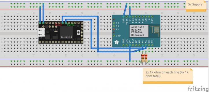

I imagine you need 2 pull-up resistors on the i2c bus. A pull-up resistor is a resistor that is in parallel to the data path, and goes between the pin and 3.3v. You will need one resistor on the SCL line connecting to 3.3v and one on the SDA line connecting to 3.3v. What value of resistor to use depends on the devices on the bus and the complexity/length of the total wires. A typical value for 3.3v systems is to use 2.2K ohm.
This is also something that I tried, but please let me know if it looks like I'm doing it wrong:
I don't currently have any 2.2K ohm resistors on hand, if I double up 2x 1K ohm on each line should that be sufficient enough to get something to work? The lines between these devices are less than a foot and I don't intent to have more than 2 Teensy's + 1 ESP8266.
In theory it should work (assuming you have the right connection between SCL/SDA and the two machines).
Note, the resistor can be higher than 2.2k. Generally 4.7k is used for 5v systems. Generally, you want it under 10k. However, higher resistors can mean that high speed I2C can be a problem.

I also tried putting 2k ohm resistors on both lines coming from the Teensy and 1k ohm resistors on both lines coming from the ESP but the result is still the same with neither device being recognized.
Hi toddwest,
some remarks:
- Wire.h libs for Teensy4 and esp8266 enable the internal pullup resistors in the chips (Teensy4 22k and esp8266 something between 20k - 50k), so it's good to use an external pullup resistor of 4,7k but nor 2 x 2k (that is much too low). On Teensy4 it depends on the setting of the DSE (Drive Strength Field).
- Wire.h lib for Teensy4 does not support slave mode. An alternative is Richard Gemmells lib, have a look at https://github.com/Richard-Gemmell/teensy4_i2c.
- For Teensy4 Richard and I made the experience that setting the HYS Bit for the SDA and SCL lines gives a more reliable I²C communication. Have a look at this thread https://forum.pjrc.com/threads/57861-I2C-Slave-on-Teensy-4/page2?highlight=Teensy4+i%B2c
Helmut
Hi hbit!
I went ahead and grabbed some 4.7k ohm resistors and replaced the 2 x 2k that I had previously. I gave the teensy4_i2c library a shot as well and it works (mostly)!
I took the excellent example code that you provided in that other thread and used the teensy in slave mode and I am able to get pretty decent i2c communication but it seems to fail suddenly with an error at a different point each time. I haven't been able to find any specific pattern to it and I've tried swapping out all of my wiring as well. Sometimes it fails at message 10, sometimes above 80 and sometimes it will run for hundreds of messages without issue.
When it fails, the slave side (Teensy) shows something like:
# rx: 10 32  tx ok
and the ESP8266 side shows something like:
tx: x is 194, rx: x is x is x is x is x is x is 193, error_counter: 2
error_counter: 2, loop_counter: 194
or like this:
# rx: 9 113  tx ok
tx: x is 120, rx: x is x iq x is x is x is x is 119, error_counter: 3
error_counter: 3, loop_counter: 120

Alright, well here is one more thing I just noticed and I hope that someone has an idea of what might be going on here.
Instead of attaching the 4.7k pull-up resistors to 3.3v I attached them to the 5v input instead and now the communication between the devices appears to be perfect. I have been running the test program for 5-10 minutes without a single error. Both the ESP8266 and the Teensy state that 5v should NOT be applied to any pins so I am concerned that this may be causing damage (or has the potential to).
I am just very confused about why this isn't reliable when connected to 3.3v but is when connected via 5v. Anyone have any thoughts?
I feel like I'm getting pretty strong evidence here that the ESP8266 is not only 5V tolerant for the SDA/SCL pins (GPIO pin 4 and 5) but that it actually requires 5v pull up to work properly. I had a bidirectional level shifter laying around so I took the SDA & SCL lines from the ESP8266 and ran it through the level shifter to bring it down to 3.3v before sending to the teensy and everything still appears to work perfectly. Edit: Actually, it doesn't work as well as the pure 5v implementation. It failed after ~2000 iterations when using 3.3v to the Teensy.
Has anyone else had this same experience? From every test that I've done it really appears that I2C with the ESP8266 will not function properly when using a 3.3v logic level despite what all of their documentation says ��

Thank you for all your help and guidance, Michael and Helmut. I think I may have finally found the correct combination to get everything to work properly with 3.3v. I'm not sure exactly what I was doing wrong but I took some time this morning to completely re-write everything from scratch and to clean everything up.
Initially after the re-wire it will still pretty flaky between the devices. I noticed that the only thing I hadn't tried was tying all of the 3v pins together, I had assumed that it was sufficient to use just the 3v pin from the ESP8266 with the pull up resistors since everything else was being powered with my 5v input (I have a separate 5v PSU). Joining all of the 3v pins appears to have solved all of my issues and the communication between each device is flawless.
For posterity here is what my final wiring looks like:
Thank you again everyone for all your help. I'm excited to keep moving this project forward!
