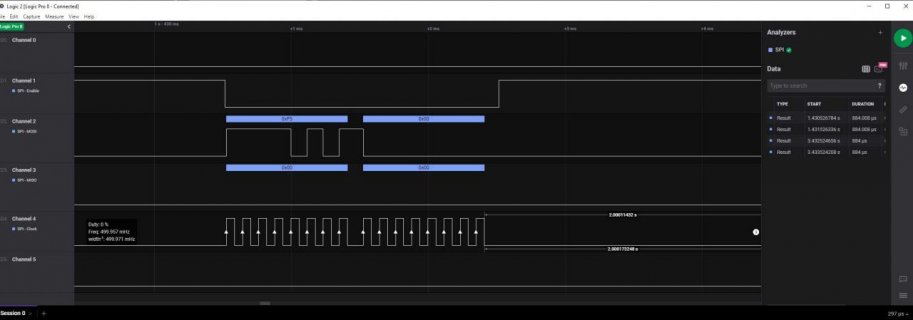

Quick update: It looks like at least some of your stuff is working... At least I can capture SPI output on Logic Analyzer:
Hi KurtE,
Well, thanks for doing that. I don't have a Logic Analyzer or oscilloscope (yet)...
I noticed on the SPI SCK signal, it says 499.971 MHz. I'm not fully sure how your tools work, but i'm assuming that is my SPI clock frequency? Clearly that is too high...
If i think about it, you must have some fancy tools to detect such a high frequency and very cleanly...
Maybe the slave (The MPU9250 on my teensy. I'll assume you have nothing connected to your teensy) is not replying because the clock is too fast?
Thanks
I ran your sketch with scope and MISO jumpered to MOSI and confirmed it read back what was sent. Scope showed SPI CLK at 8.4 khz which matches your config of CCM_CBCMR, CCS, and TCR, 664.6/6/102/128. Your TCR is set to MODE1 with 128 prescale, you probably want TCR = 7. That will give you MODE0, and SPI CLK will be 1.08 MHz (without 128 prescale). Here are hex values of a few registers of your sketch vs using Teensy SPI lib.
       LPSPI4_CCR 0xA030064
       LPSPI4_TCR 0x78000007
       LPSPI4_FCR 0xA000A
       CCM_CBCMR 0xF5AE8104
Teensy SPI lib with SPI CLK 4 MHz, MODE0, 720.3/3/60  = 4 MHz
          LPSPI4_CCR 0x1D1D3A
          LPSPI4_TCR 0x7
          LPSPI4_FCR 0x0
          CCM_CBCMR 0xE9AE8114
https://github.com/PaulStoffregen/SPI
EDIT: running your sketch at 1.08 MHz (MODE0) with T4 connected to SPI serial flash, I was able to read the flash ID, memory type, and capacity
LPSPI4_TCR 0x7
LPSPI4_FCR 0xA000A
CCR freq 1.1 MHz

You are welcome, @manitou did a much more thorough test than I did, I just hooked up a T4 to Logic Analyzer pins.
And yes I do have a couple of logic analyzers from Saleae: https://www.saleae.com/
These days I seldom debug anything hardware wise without them. Likewise for many software issues as well.
(Sorry for the shameless plug)
I am also using their Alpha or is it now Beta version of their software full rewrite as talked about up at: https://discuss.saleae.com/
