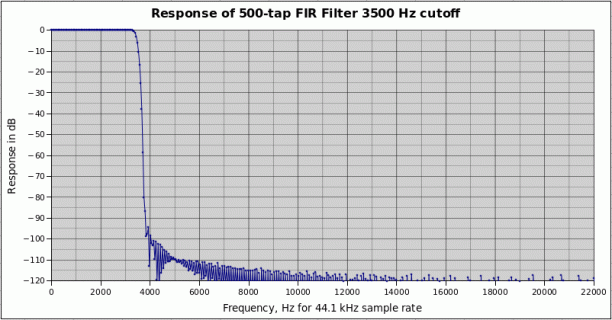

Here is the response of a low-pass filter with 500 taps, showing the general characteristics of the Kaiser window:
The needed math functions are included with the next two listings, so I believe this pair of .h and .cpp files, placed into a personal library folder, AudioFilterFIRGeneral_I16 should work. Eventually the two math functions should be separated. Also, don't miss the many notes in the two files, particularly the top of the .h file. Here are the AudioFilterGeneral_I16.h and .cpp

  // A simple, but sharp cutoff, 500-tap low-pass filter with 80 dB first sidelobe.
  nFIR = 500;  sidelobes = 80;
  for(i=0; i<250; i++) {
      if (i<40) dbA[i] = 0.0f;  // fco about 22050*40/250, about 3500 Hz
      else dbA[i] = -140.0f;

  // Get frequency response in dB for 500 points, uniformly spaced from 0 to 22050 Hz
  firg1.getResponse(500, dBResponse);
  Serial.println("Freq Hz, Response dB");
  for(int m=0; m<500; m++) {       // Print the response in Hz, dB, suitable for a spread sheet
       Serial.print((float32_t)m * 22050.0f / 500.0f);
       Serial.print(",");
       Serial.println(dBResponse[m]);

AudioInputI2S               i2s1;   // Creates timing
AudioFilterFIRGeneral_I16   firg1;
float32_t dbA[2000];
float32_t stateArray[4128];
float32_t workSpace[4128];
float32_t equalizeCoeffs[4000];
int i, k;
float32_t dBResponse[5000];  // Extreme size, can show lots of detail!
// Following is based on Rabiner, McGonegal and Paul, FWFIR test case, but has
// had the windowing effect divided out to show their basic filter response.
float32_t hpCoeff[55]={
-0.003643388f, -0.007195844f,  0.012732424f, -0.007796006f, -0.004276372f,
 0.013760401f, -0.012262941f,  0.000000304f,  0.013553423f, -0.016818445f,
 0.005786355f,  0.011693321f, -0.021220577f,  0.013364335f, 0.007566100f,
-0.025227439f,  0.023410856f, -0.000000305f, -0.028612852f, 0.037841329f,
-0.014052131f, -0.031182658f,  0.063661835f, -0.046774701f, -0.032787389f,
 0.151364865f, -0.257518316f,  0.300000700f, -0.257518316f, 0.151364865f,
-0.032787389f, -0.046774701f,  0.063661835f, -0.031182658f, -0.014052131f,
 0.037841329f, -0.028612852f, -0.000000305f,  0.023410856f, -0.025227439f,
 0.007566100f,  0.013364335f, -0.021220577f,  0.011693321f, 0.005786355f,
-0.016818445f,  0.013553423f,  0.000000304f, -0.012262941f, 0.013760401f,
-0.004276372f, -0.007796006f,  0.012732424f, -0.007195844f, -0.003643388};
void setup(void) {
  uint16_t nFIR = 4;
  float32_t sidelobes = 45.0f;
  AudioMemory(5);
  Serial.begin(300);  delay(1000);
  Serial.println("*** Test Response of FIR General routine for I16 ***");
// Un-comment one of the following, or use the direct Coefficient load that follows
// Test case for odd nFIR from Burris and Parks Example 3.1
//   nFIR = 21;  sidelobes = 0.0;  // No window
//   dbA[0]=0.0;    dbA[1]=0.0;    dbA[2]=0.0;    dbA[3]=0.0;    dbA[4]=0.0;  dbA[5]=0.0;
//   dbA[6]=-140.0; dbA[7]=-140.0; dbA[8]=-140.0; dbA[9]=-140.0; dbA[10]=-140.0;
// Test case for even nFIR from Burris and Parks Example 3.2
//  nFIR = 20;  sidelobes = 0.0;
//  dbA[0]=0.0;    dbA[1]=0.0;    dbA[2]=0.0;    dbA[3]=0.0; dbA[4]=-120.0; dbA[5]=-120.0;
//  dbA[6]=-120.0; dbA[7]=-120.0; dbA[8]=-120.0; dbA[9]=-120.0;
// Test case for odd nFIR from Burris and Parks Example 3.1 with Kaiser Window
//   nFIR = 21;  sidelobes = 45.0f;
//   dbA[6]=-140.0; dbA[7]=-140.0; dbA[8]=-140.0; dbA[9]=-140.0; dbA[10]=-140.0f;
//   nFIR = 20;  sidelobes = 45.0f;
//   dbA[0]=0.0;    dbA[1]=0.0;    dbA[2]=0.0;    dbA[3]=0.0; dbA[4]=0.0; dbA[5]=-120.0;
// Rabiner, McGonegal and Paul, FWFIR test case, HP Kaiser SL=60, fco=0.35
  nFIR = 55;  sidelobes = 60.0;
  for(i=0; i<28; i++) {
     if (i<20) dbA[i] = -120.0f;
     else dbA[i] = 0.0f;
// The next 3 examples are tests of extremely large FIR arrays and *only for Teensy 4*
// Generate a response curve for our "octave" equalizer, tried with 30 dB sidelobes
// Plot these first two qwith a log frequency axis.
// Patience required for the calculations (they update fast enough), but frequency
// response calculation is slow
//   nFIR = 4000;  sidelobes = 30.0f;
//   dbA[0] = 12.0f;  // Avoid log(0)
//   for(i=1; i<2000; i++)
//       dbA[i] = 12.0f*cosf(10.0f*log10f(11.02925f*(float32_t)i));
// Generate a slowly changing response, up 12 dB at bass and treble and -12 dB
// for mid-frequencies.  Scaled to "octaves" by the form cos(log(f))
//  nFIR = 3999;  sidelobes = 30.0f;
//  dbA[0] = 12.0f;
//  dbA[1] = 12.0f;
//  for(i=2; i<2000; i++)
//      dbA[i] = -12.0f*cosf(2.2f*log10f(11.02925f*(float32_t)i));
// Narrow band "CW" filter, tried with 60 dB sidelobes (60 to 80 or 70 to 72
//   nFIR = 3999;  sidelobes = 60;
//   for(i=0; i<2000; i++) {
//      if (i<70 || i>72) dbA[i] = -120.0f;
//      else dbA[i] = 0.0f;
  // Initialize the FIR filter design and run
  uint16_t eq = firg1.FIRGeneralNew(&dbA[0], nFIR, &equalizeCoeffs[0], sidelobes, &stateArray[0], 16384.0f);
  if (eq == ERR_FIRGEN_BANDS)
    Serial.println("FIR General failed: Invalid number of frequency points.");
  else if (eq == ERR_FIRGEN_SIDELOBES)
    Serial.println("FIR General failed: Invalid sidelobe specification.");
  else if (eq == ERR_FIRGEN_NFIR)
    Serial.println("FIR General failed: Invalid number of FIR coefficients.");
    Serial.println("FIR General initialized successfully.");
// Load (if not commented) non-windowed HP filter coefficients, test case:
// firg1.LoadCoeffs(55, hpCoeff, workSpace);  // Direct load of FIR coefficients, already calculated
  Serial.println("FIR Coeffs");
  for(i=0; i<nFIR; i++)
      Serial.println(equalizeCoeffs[i], 7);
  Serial.println("");
  // Get frequency response in dB for 5000 points, uniformly spaced from 0 to 22058 Hz
  // This is chosen at 5000 for test.  Normally, a smaller value,
  // perhaps 500, would be adequate.
  firg1.getResponse(5000, dBResponse);
  for(int m=0; m<5000; m++) {       // Print the response in Hz, dB, suitable for a spread sheet
       // Uncomment/comment next 3 for print/no print
       Serial.print((float32_t)m * 22058.5f / 5000.0f);
       Serial.print(",");
void loop(void) {
