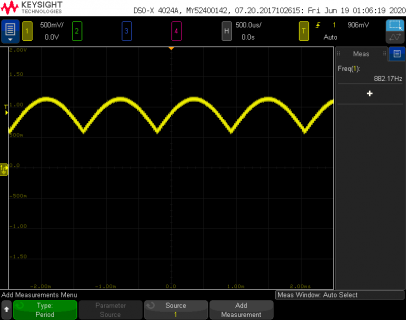

Interesting. I see your point, but the api seems to be doing the heavy lifting because it works as specified. Here's a proof.
#include <SerialFlash.h>
AudioSynthWaveformSineHires sine_hires1; //xy=773,891
AudioEffectRectifier rect1; //xy=1096,933
AudioOutputI2S i2s1; //xy=1271,810
AudioOutputUSB usb1; //xy=1283,1057
AudioConnection patchCord1(sine_hires1, 0, i2s1, 0);
AudioConnection patchCord2(sine_hires1, 0, usb1, 1);
AudioConnection patchCord3(sine_hires1, 0, rect1, 0);
AudioConnection patchCord4(rect1, 0, usb1, 0);
AudioConnection patchCord5(rect1, 0, i2s1, 1);
AudioControlSGTL5000 sgtl5000_1; //xy=992,1058
AudioMemory(10);
sgtl5000_1.enable();
sgtl5000_1.volume(1);
// noise1.amplitude(0.5);
// waveform1.begin(WAVEFORM_SINE);
sine_hires1.amplitude(1);
sine_hires1.frequency(1000);
Serial.println("Nothing");
While testing your code I realized that what you've implemented is a half-wave rectifier. I had needed a full-wave rectifier and got confused. Sorry about that.
However, if you are doing a half wave rectifier wouldn't this be a lot simpler?
  for (i=0; i < AUDIO_BLOCK_SAMPLES; i++) {
    if(block->data[i] < 0)block->data[i] = 0;
Pete
