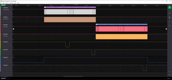

With the test sketch reading 4 sensors, with two on Wire and two on Wire1 (T4 in this case). Note: You are not getting any speed benefit from using the two wire busses as any time we are doing any Inputs our outputs the code is sitting waiting for the transfers to complete.

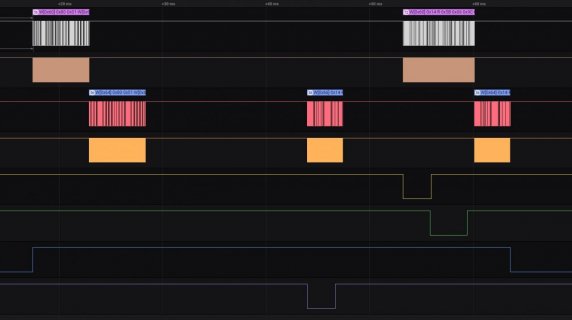

With the default reading, where I simply call the API one after another in Synchronous mode it looks like:
I have new code now that allows me to start up a range operation without waiting for the operation to complete. SO I startup all 4 and then wait for each GPIO pin to signal that it completed and then do a query. Right now when all of the sensors have nothing in range they all signal in same order as when I started them. What is also interesting is when something is within range it at times takes longer for the sensor to signal completion...
Note: the blue line (second from bottom) I am not showing the third sensor, but instead timing of the operation. As this took up all 8 signals of this LA... Could grab my older 16 channel one, but... good enough for now.
You can see how in this case it may reorder when the ones signal.

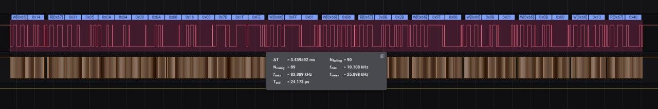

What is also interesting is just how much data is being transferred to read in one range operation and reset the interrupt. You can see one of these transfers here:
Again wondering if some of this can be streamlined, but maybe not worth it.
