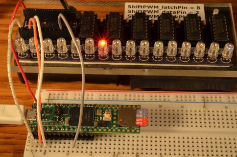

I tried ShiftPWM using its "ShiftPWM_RGB_Example" and the test hardware I built years ago with six 74HC595 chips and RGB LEDs.
I had the edit the example like this to make it compile.
 #define SHIFTPWM_NOSPI
 const int ShiftPWM_dataPin = 2;
 const int ShiftPWM_clockPin = 1;
At first glance, it seems to be working.
However, when I watch carefully I can see some slight "ghosting". It's difficult to photograph, but I was able to get this shot where you can see some light blue light coming from the last LED and some red and green from others, when only 1 LED is supposed to be on fully red.
I tried running at different speeds. The problem seems to go away if I run Teensy 4.1 at only 396 MHz, and it gets much worse if I overclock to 720 MHz. So my guess is the delays we currently have in the code might not be quite right.
Hey Paul thanks for the clarification. I got it working, ended up being a soldering issue. But now I'm having another problem that might be software related.
Basically I cant turn on led 24 without turning on led 23.
    ShiftPWM.SetRGB(8, 150, 150, 150); //turnes on 4 leds (23,24,25,26)
    ShiftPWM.SetRGB(8, 0, 150, 150); //turnes on 2 leds (25,26)
    ShiftPWM.SetOne(23,150); //turnes on 1 led (23)
    ShiftPWM.SetOne(24,150); //turnes on 2 leds (23,24)
maybe this is related to the ghosting?

*edit* Actually having it at 396 MHZ seems to fix the issue
