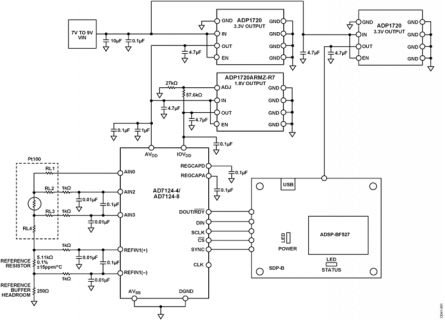

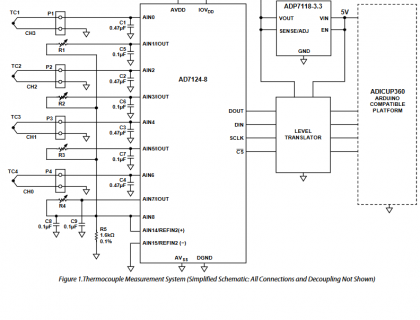

Hi guys, girls,
I was wondering if you could share a light on the following AD7124. at the example code, I need to change it to read RTC and thermocouple channels. but how to read it is different to the CN0391 evaluation board. i have attached 2 images 1 for the cn0391 schematic and the other the CN0381.
the link to the pdf:
https://www.analog.com/media/en/technical-documentation/data-sheets/ad7124-8.pdf
the procedure to communicate with the CN0391 and CN381 is kinda identical.

//measuring Thermocouple
1.Reset the ADC.
2.Select the power mode.
3.Set the CHANNEL_0 register analog input to AIN0/AIN1. Assign Setup 0 to this channel. Configure Setup 0 to have a gain of 128 and select the reference source to REFIN1(±). Select the filter type and set the output data rate.
4.Set the CHANNEL_1 register analog input to AIN2/AIN3. Assign Setup 0 to this channel (both channels use the same setup).
5.Set the CHANNEL_2 register analog input to AIN4/AIN5. Assign Setup 1 to this channel. Configure Setup 1 to have a gain of 1 and select the reference source REFIN2(±). Select the filter type and set the output data rate.
6.Program the excitation current and output the current on the AIN4 pin.
7.Enable both CHANNEL_0 and CHANNEL_1. Enable the DATA_STATUS bit to identify the channel from which the conversion originated. The ADC automatically sequences through these channels.
8.Wait until RDY goes low. Read the conversion value.
9.Repeat Step 8 until the temperature is to be read (every 10 conversions of the pressure sensor readings, for example). 10.Disable CHANNEL_0 and CHANNEL_1. Enable CHANNEL_2. 11.Wait until RDY goes low. Read the conversion.12.Repeat Step 6 to Step 10.
so i require to make 4 functions which read RTD, TC1,TC1 and TC2.
and give them the channel parameters, voltage references, currents etc. I got that.
things I dont understand:
  • how do I enable both channels 0 and 1 at the same time?.
  • how do I program the excitation current?
  • what I dont understand is the until ready and how to active it
I have attached the ad7124 with out any tweaking for convenience.
