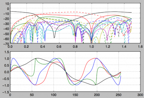

Through experimentation with such strings of operators with a variety of frequency changing
steps its clear that a rich variety of partials ought to be possible:
The top plot shows the variation in harmonic levels as the modulation depth (= offset sizes)
is varied - clearly rich structure, and the fundamental (black) drops in places as do most
harmonics (even = solid, odd = dashed). There was a string of 6 operators and various
frequency shifts in this experiment.
[Some example waveforms at different modulation depths are given in the bottom plot]
