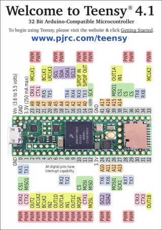

    Thank you so much KurtE. I thought it depended on the Teensy but I understood now. I took a look at the data sheet of the pressure sensors. They don't have a pull-up but recommended min 1k. Therefore, I will try the "work around" (without pull-ups) once the sensors have arrived.
    Regarding the SPI pins of the Teensy 4.1, can you explain me why the pin-out picture states that pins 10, 36 and 37 are regarded as "CS" but pins 0 and 38 are "CS1"? Can I connect the 3 sensors on the "CS" pins?

    You can use any 3 pins for CS.
    The pins marked "CS" on the card have the ability to be used in a special hardware optimized way. But that optimization gives only very small benefit for most uses and costs a lot of complexity inside the library code, so most libraries don't use it. Unless documentation for the library specifically says you must use those pins, you can connect the CS signals to any digital I/O pin (some Teensy models have analog-only pins, but Teensy 4.1 does not).
    So the take-away is you can choose whatever 3 pins are convenient for the 3 CS signals. You don't need to use the pins marked "CS" (unless you find a library which specifically says to do so). But there's no harm in choosing those pins marked "CS" even when the library will access them as if they were just ordinary digital pins.

    PaulStoffregen, Thank you so much! That makes a lot of sense!
