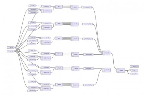

Hello friends
I cannot start the LFO phase with Midi NoteOn at zero degrees. The phases are synchronous but continue to run. What am I doing wrong.

Thanks for help. Greetings Rolf
Hi
Ok I think the problem is with the audio buffer. I will use another audio function with sync for the waveform oscillators.
Here is an example from UHF from the forum
 ElectroTechnique 2020

My Synth block with 6 voices (Still at work)
Greetings Rolf
