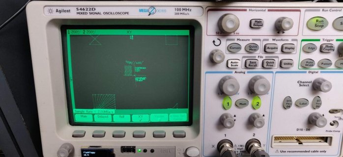

I'm basically aiming to make an improved VST board: https://github.com/osresearch/vst, the old teensy 3 did not have enough memory to buffer a full frame of data, so it had to render the scene realtime, filling a spi buffer that was DMA'ed out in the background to the Dacs, but this would often cause sparkling or bright spots as the rendering speed changed. From what I can tell, the teensy 4 should have no problem buffering an entire scene in advance and spamming it out at a fixed rate, no DMA needed.
Here is a teensy 3 running the old VST program:
(XY works a lot better on the older scope)
Thanks again for your suggestions, I should have waited a day to post my question.
