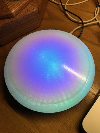

Something a little different from my prior audio/LED projects - an inexpensive 241 LED circular array, driven by a Teensy 3.2 to create a pseudo plasma effect. I printed an enclosure with translucent PLA and the infill pattern diffuses the LEDs such that the light smears out in interesting patterns. Simple design, simple code and really nice effect.
// Ring Panel - a simple audio device that utilizes 241 LEDs in concentric rings.
//   A Teensy 3.2 + the Teensy Audio Adapter is utilizes to sample the incoming
//   stereo audio signal and generate the color pattern to be displayed.  The left
//   and right channels are mixed then run through the Teensy FFT audio library
//   function to get 512 frequency bins of level information.  The color pattern
//   sums two adjacent bins (0+1, 1+2, etc.) to create a level value that controls
//   the brightness of each of the 241 pixels.  The display start with the lower
//   frequencies in the center and moves outward.
//    Note that the ring is mounted in a translucent 3D printed case that diffuses
//    the LED output, creating a simulated plasma effect.
//   Based on sample code from Adafruit and prior Teensy projects
//   Rev 1.0 - Nov 18, 2020
