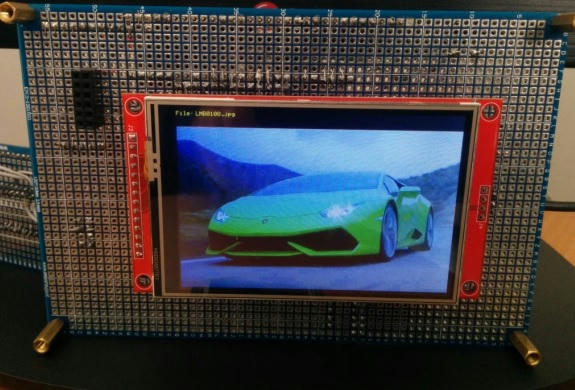

  14. #39
    Senior Member
    Join Date
    Dec 2016
    Posts
    105
    Thanks for your constant work on improving the working environment for teensy boards. Great effort.
    I am getting familiar with the ILI9488_t3 library and the settings to SdFat. Today I was reviewing the JPEGDEC library; To migrate the old projects to the new screen, I was compiling some examples that worked well in the IDE 1.8.13 with the Teensy Loader 1.54-beta3.
    Now with the Teensy Loader 1.54-beta5 only errors jump like rabbits!
    C:\arduino-1.8.13\hardware\teensy\avr\libraries\SD\src/SD.h:159:49: error: 'FILE_READ' was not declared in this scope
      File open(const char *filepath, uint8_t mode = FILE_READ) {
    C:\arduino-1.8.13\hardware\teensy\avr\libraries\SD\src/SD.h: In member function 'virtual File SDClass::open(const char*, uint8_t)':
    C:\arduino-1.8.13\hardware\teensy\avr\libraries\SD\src/SD.h:161:15: error: 'FILE_WRITE' was not declared in this scope
       if (mode == FILE_WRITE) flags = O_RDWR | O_CREAT | O_AT_END;
    JPG_decoder: In function 'void* myOpen(const char*, int32_t*)':
    JPG_decoder:5: error: call to 'virtual File SDClass::open(const char*, uint8_t)' uses the default argument for parameter 2, which is not yet defined
       myfile = SD.open(filename);
    SliderJPG: In function 'void loop1()':
    SliderJPG:5: error: call to 'virtual File SDClass::open(const char*, uint8_t)' uses the default argument for parameter 2, which is not yet defined
       File dir = SD.open("/");
    Is the JPEGDEC library still compatible with the settings made to SdFat (formerly SdFat beta)? .

    Quote Originally Posted by TFTLCDCyg View Post
    I was able to reproduce this problem. It's a bug in the new SD.h, where it's a bit too aggressive about undefining the incompatible FILE_READ and FILE_WRITE from SdFat.h. When headers are included in an unexpected order, as the JPEGDEC example does, SD.h was undefining the correct values, and then FS.h was not redefining them because it had already been included. That causes code elsewhere in SD.h to not compile because we undefined them, expecting FS.h to define them properly.
    I've committed a fix on github.
    https://github.com/PaulStoffregen/SD...40572d10ff368b

  20. #45
    Senior Member
    Join Date
    Dec 2016
    Posts
    105
    THX Paul.
    I put these lines at the beginning of the SD.h file:
    // Use FILE_READ & FILE_WRITE as defined by FS.h
    //#ifdef FILE_READ
    #if defined(FILE_READ) && !defined(FS_H)
    #undef FILE_READ
    //#ifdef FILE_WRITE
    #if defined(FILE_WRITE) && !defined(FS_H)
    #undef FILE_WRITE
    #include <FS.h>
    Now both libraries: SD and JPEGDEC can coexist without problems.
    Teensy 4 + ILI9488 3.5" + SD + JPEGDEC
    Thanks for the prompt response.
