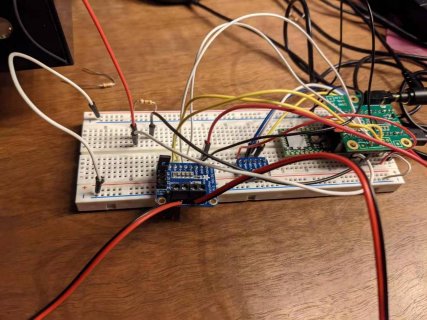

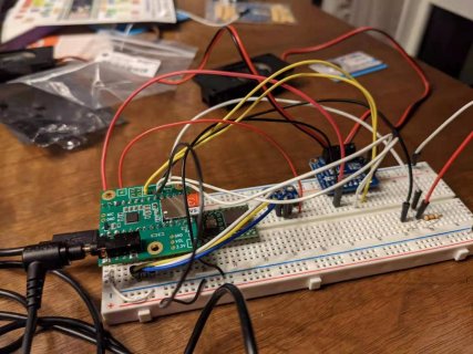

Hello! For my project, I am trying to build a cube that records audio while a user is holding it (and then plays it back later). I'm using the Teensy 4.1 with Rev D audio shield, Adafruit's SPH0645 microphone (https://www.adafruit.com/product/3421), and the Max98306 amplifier breakout board (https://www.adafruit.com/product/987) to boost line out audio from the audio shield to a pair of speakers. Pictures of the current setup:
Currently the microphone records fine, saves to the SD card fine, and plays audio back fine (though there is a little noise and it is a little quiet).
For capacitive sensing I'm using the Capacitive Sensor library to run wires on pins 19 and 16 to create a capacitive sensing circuit, which also works fine on its own. (https://playground.arduino.cc/Main/CapacitiveSensor/)
The problem is that if I try and read a capacitive touch with capacitiveSensor during recording of audio, the audio can't record at the same time. I'm not that great at physical computing, and I can only imagine it's a problem of the microcontroller not being able to do both things at once, but I thought maybe someone else would have an idea of how to skirt around the problem. I tried only reading capacitive touch every two seconds, but even that resulted in an audible break in the recording. This is a problem because I need to know when the user has let go of the cube.
Current code is below -- some of the experimentation I was doing with averaging to smooth the signal is commented out. Thank you in advance for any advice!

Teensy 4.1 should be fast enough if your code is using interrupts but I guess the Arduino library is not fast enough, but did you read this? Looks like that lib isn't required when using a Teensy with version number more than 2? Here's a guide for Teensy 3.6.
One simple way to get around this is to use dedicated touch hardware. I've used the MPR121 for several projects and it's very easy to use and offers an IRQ pin that can be used with interrupts to read the device only when a change has occurred. Adafruit has a nice breakout for this https://www.adafruit.com/product/1982
