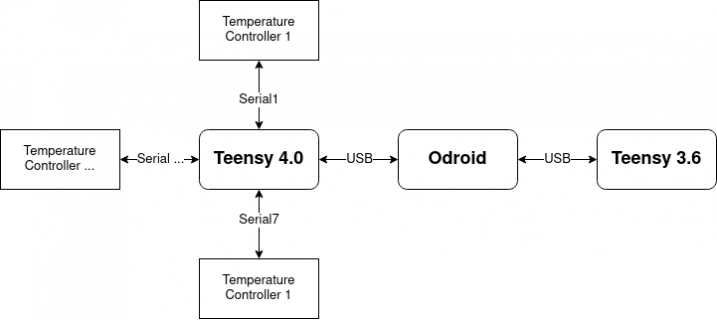

we recently started to use some Teensy boards in various parts of our product. Everything is working great, but I have a random loss of bytes during USB communication.
The system I am working on is this:
(NB: Serial7 is connected to Temperature Controller 7 of course, is a typing error)
I am programming both boards with PlatformIO and the Teensy framework, while on the Odroid I have a Python program that interface with USBs and is bouncing messages back and forth to allow communication between the boards.
Basically, the Teensy 3.6 wants to control the temperature controllers, so
  • it sends a message to the Odroid
  • the message is bounced on the Teensy 4.0 over USB
  • then bounced on the proper temperature controller on the hardware serial port
  • the answer of the temperature controller is then doing the path in the opposite direction

Yes I think you should determine where in the system the error is happening. Your description of the problem lead me to believe it is in the return data, Teensy4 --> Teensy3. Your examples seem to show the code sending the data out to the Teensy4 from the Teensy3.
Your serialEvent interrupt handler could perhaps be causing the issue. In the code you show, it is calling Serial.write. If the interrupt happens while the main loop of functions is also calling Serial.write, then that could lead to data corruption. ( unless the underlying arduino library protects the user from such an error ). If this were the case I would expect your corrupted data to look like "ooo.M.messooo.M.message 2\nage 1\n" showing that a interrupt happen while message 1 was being written in loop, message 2 interrupted, and then message 1 finished.

I am writing after some time since probably I found the solution.
During my tests, the serial port was opened and closed by the Odroid on which I was testing the system, but the Teensy were not rebooted. When the port is closed for a big amount of time, I imagine the serial buffer becomes full and messages become corrupted.
To avoid this problems, I implemented three pieces of code:
(1) Inside the setup function wait until the serial port is opened.
while (!Serial) {}
(2) Every time a serial communication is attempted
if (Serial) {
    Serial.print(...);
(3) Periodically, inside the loop
if (!Serial) {
    Serial.clear();
This last piece of code is added in case the port is closed by the Odroid while the communication is happening, so that characters still in the buffer are cleared.
