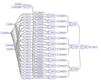

To confuse everyone a little bit more, here is my setup of all blocks:

Seems like if one object connects to too many inputs, there are problems
Try increasing your AudioMemory allocation.
The connections are implemented using shared copy-on-write buffers. So if you transmit an output to 100 inputs, and all 100 of them do not modify the data, then they all read from the same buffer the output wrote. But if 95 of them modify the data, then 95 copies of the buffer are made, drawing upon the pool of buffers you allocated with AudioMemory(), and the 5 which don't change anything read the original buffer.
If the audio library needs to make 95 copies of you data and there aren't 95 buffers available, then it uses up all the memory it can and the rest of those objects get nothing at their inputs. And if the last one to get an input needs to allocate memory to do its work, it gets nothing and probably gives no output. Generally, when memory runs out, you get difficult-to-predict audio dropouts from various places in your audio system.

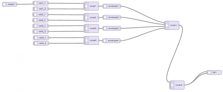

I reduced the setup to the following, to reduce the likelihood of it being a lack of resources:
The problem still persists. I have no idea what could be causing this, since I can alter the parameters of my main oscillator blocks just fine, even with all 12 voices. Only the DC blocks and the waveforms are problematic.
