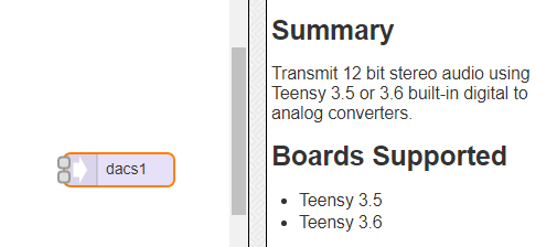

I noticed that you define this:
AudioOutputAnalogStereo dacs1;
However, a stereo DAC is not supported on Teensy 3.2:
Not sure what you see on pins 9 & 11 though...

Yeah, whatever. Now you're using the correct pin for the DAC on a Teensy 3.2.
But there's still a mystery.
I've had a look at the code for AudioOutputAnalogStereo and it is specifically coded to handle only a Teensy 3.5 or 3.6 because they are the only Teensys which have two DACs.
If it is compiled for any other processor it will use this code:
#else // not __MK64FX512__ or __MK66FX1M0__
void AudioOutputAnalogStereo::begin(void)
void AudioOutputAnalogStereo::update(void)
	audio_block_t *block;
	block = receiveReadOnly(0); // input 0
	if (block) release(block);
	block = receiveReadOnly(1); // input 1
The begin function does nothing at all, so no DAC is setup.
What the update does is look for an audio input block on the left or right channels. If it receives one, it immediately releases it (i.e. it throws it away). The end result is that nothing is output to a DAC.
Pete

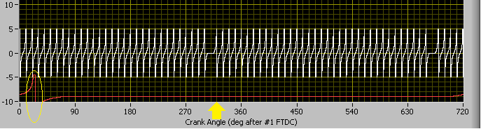

This is my code. It works.
Is it now possible to send only x period type and x period of another type?
Example send 58 sine wave and send 2 empty wave (= 0) and return send 58 + 2 .....
An idea ?
here in this picture send 35 + 1 (white signal)

I was thinking of using something like this :
Can it work?
    if (flag == 1 && count < 2)
      waveform1.amplitude(0.0);
      count=count+1;
          if (count == 2) {
          flag = 0;count = 0;
    if (flag == 0 && count < 59)
      waveform1.amplitude(1.0);
      count=count+1;
          if (count == 59) {
          flag = 1;count=0;
It might work if it was counting audio cycles but as far as I know there's no way to do that.
Pete
is it possible to stop an audio wave when you want it and that it stops when the phase only = 0 ?
My idea is to generate on a pwm pin a signal (50%) at the same frequency as the sine wave. And count the number of pwm pulse on another pin. If I reach 58 pulse stop the sine wave (or amplitude = 0) and after 2 pulse restart it (or amplitude = 1).
No Nico, there are no api calls that allow that.
But why don't you just look at the sourcecode? It is not forbidden to modify it, and answers all questions ;)
