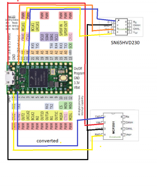

Teensy 4.0 and CAN using SN65HVD230
Hello everyone. I'm having trouble switching from 5V to 3.3V logic for CAN transceivers. I'm currently using MCP2551s but the 'problem' is that it needs a lot of cabling as I need to drive the voltage down using logic converters. And so I've decided to use a SN65HVD230. I've built up my testing rig and .... *pfffff*. Nothing. I've set up my Teensy 4.0 to use two CAN controllers CAN 1 and CAN 2 (I'm actually driving three but I don't thing that matters here). CAN 2 is connected to the MCP2551 via a logic converter and the SN65HVD230 is connected to CAN1.
I connect a CAN-2-USB converted to a PC and see if I'm receiving a message.
Teensy creates an identical message for both buses with the exception that CAN 1 has a message with ID=1 and CAN 2 has a message with ID=2.
When reading CAN buses I can see CAN 2 messages but not CAN 1.
Can someone tell me what am I doing wrong? Maybe it has something to do with the library? I'm using a FlexCAN_T4. Maybe I've screwed up my connections? Or maybe the SN65HVD230 just doesn’t play well with Teensy 4.0, though I think I did see examples of people getting it to work.
If anyone could help me, I'd appreciate it.
Cheers,
Rafał Typiak

Connection diagram below
toggle a led in your loop() to make sure the loop() is still running, also check your CAN lines are terminated
I could do that but I don't think that's necessary as I know that the loop is running. I am getting CAN messages on CAN 2, just not CAN 1. I'm reading from both at the same time.
I've modified my board a bit by adding goldpins on Teensy's Rx and Tx for CAN 1 and CAN 2. During operation I've switched between both bus controller outputs and found that the MCP2551 can read data coming from both controllers. It outputs ID 1 frames when connected to CAN 1 and ID 2 frames when connected to CAN 2. The SN65HVD230 - nothing.

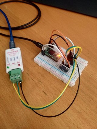

Made a quick setup using a Teensy 4.0 and 2 of those cheap TI SN65HVD230 CAN-bus transceiver modules.
This is the setup:
I connected the CANL & CANH signals from both transceivers to a CANbus analyzer [the yellow & green wires].
This is the transceiver module:
With this code...

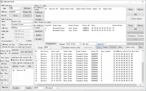

... I saw this on the CAN bus analyzer:
The bottom-right window shows the frames with alternating frameIDs and correct timing.
So the cheapo transceivers seem to work well with Teensy 4 and the FlexCAN_T4 library. I guess you need to dig into the MCP2551-based transceiver and its wiring.

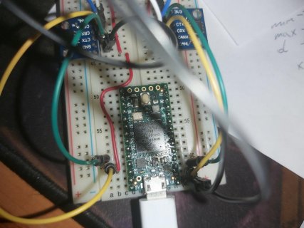

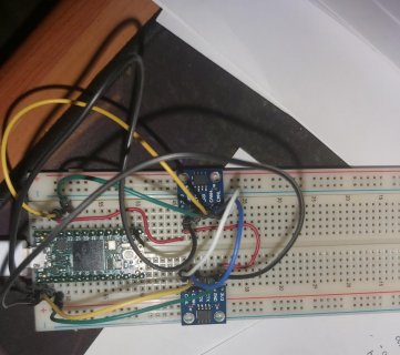

Hi guys,
sorry for the delay but COVID makes things so hectic at work that it's hard to find the energy for anything more.

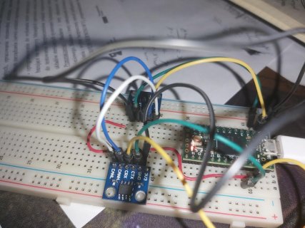

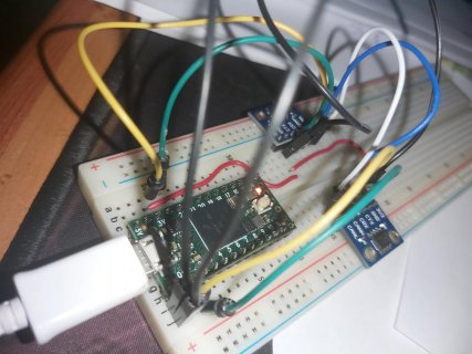

So I've tried a new setup and I still keep failing.
Here's my new setup. It's a completely new Teensy (the transceivers are the same).
I've used the following code:

Neither controller returns a message information.
What am I doing wrong? Can it be the library? I know that this library works with the MCP2551 unit as I was able to send CAN data from a PC to Teensy using this lib.
Wiring seems ok. I've used full rod cables previously but have switched to those seen in the photos as the original ones weren't colour coded.
Do I need to take out the oscilloscope? If so what should I be looking for? Should data transfers bee only visible on Tx when there are no CAN_L and CAN_H cables connected?
Thanks for any help you can spare.

Hi Rafal,
Saw from the photo's that you copied my setup, good, than we have the same setup hardware-wise. Your wiring seems to be OK.

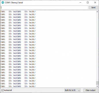

Ran your code from message #7 and everything seems to be working well!?
Here is the serial output:
and the CAN analyzer output:
What version Arduino/Teensyduino are you running? I'm on Arduino 1.8.13, Teensyduino 1.53.
Teensyduino 1.53 comes with the latest FlexCAN_T4 library. Is there perhaps an other/older FlexCAN_T4 library in your C:\Users\xxxx\Documents\Arduino\Libraries\ folder?
Using a scope, you should see activity on the CTX & CRX pins. And on the CANL & CANH lines.

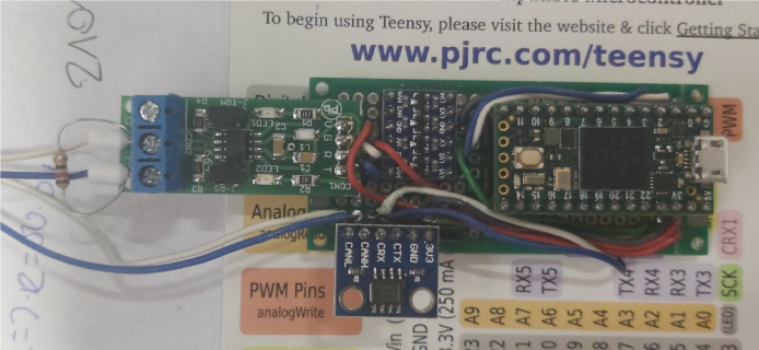

Hi I have the same setup but with a teensy 4.1 and using 2.0.4 with teensy1.57.2 I can't get it to receive any of the signals from the canbus. I would upload pictures but I get an error when I attempt to do so
Hello, were you able to figure out the problem? We have hooked up our can lines to an oscillascope and even when we are trying to transmit a can message both lines read a nominal value of 0. We have checked all of the solder points and they are all hooked up well. We have wired up a teensy 4.1 in the same way you have your 4.o wired up in the image. Any help would be appreciated. We are using the code that you posted, copied and pasted

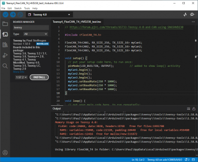

Just ran the code from my message #6 above, using the exact same hardware, but this time compiled with ArduinoIDE 2.0.4 & Teensyduino 1.58.0:
Program runs fine and shows the same on the CAN Analyzer.
Please double-check your wiring and perhaps swap CAN transceiver modules?
