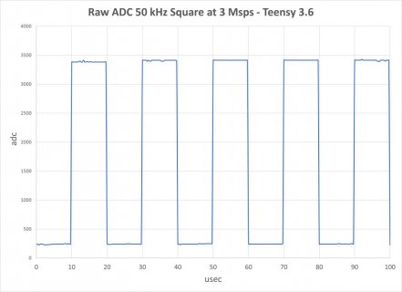

I have been working on new features for SdFat. Two are useful for Teensy 3.6 and Teensy 4.1.
The first is a ring buffer that is tightly integrated with SdFat and can be called from an ISR. As a test, I did a DMA ADC logger and stress tested it with the max ADC over-clocking on Teensy 3.6. Here is a chart of a 50 kHz square wave at 3 million samples per second.
I have attached the the .ino file for the logger and RingBuf.h, the template for the ring buffer. You can run them with SdFat 2.0.4.
The second feature is a rework of the Teensy SDIO driver. I have been able to get sd busy to work. I also overlap sending data to the sd with execution of the program. I do this by writing a sector to the SDHC FIFO then returning while the data is sent over the SDIO bus. On Teensy 4.1, writing the first sector takes 10-11 usec which includes time to put the controller in write mode. Subsequent sectors take 5 usec.
the isBusy feature plus the short write time allows a simple non DMA program to log data at over 25 kHz.
Here is the loop that logged the data for the above chart. It logged by printing text to a RingBuf object.

I will release a beta of the new driver soon. The isBusy feature is of limited use for Teensy 3.6 since it can't do infinite writes before a reset, only 0xffff sectors.
