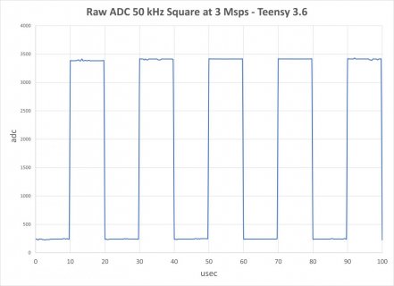

The RingBuf class can be used in an ISR. I did a ping-pong ADC DMA test with Teensy 3.6 over-clocking the ADC and am able to log 6MB/sec.
Here is a link to that demo.
https://forum.pjrc.com/threads/65836-SdFat-DMA-over-clocked-3-Msps-ADC-logger?p=267092#post267092
I have posted the mods to the Teensy SDIO driver that allow fast simple loggers and the ring buffer for use in SRAM_L/SRAM_U on Teensy 3.6.
Try the TeensyDmaAdcLogger and TeensySdioLogger examples.
Enable this line in TeensyDmaAdcLogger on a Teensy 3.6 to log an overclocked ADC at 6 MB/sec or 3 Msps.
// in loop()
//overclock(); // 3 Msps on Teensy 3.6 - requires high quality card.
